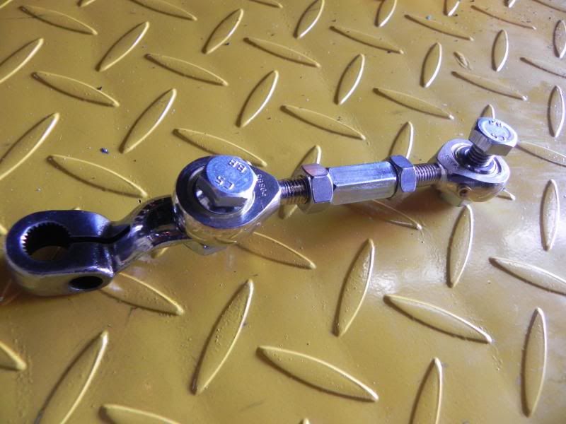

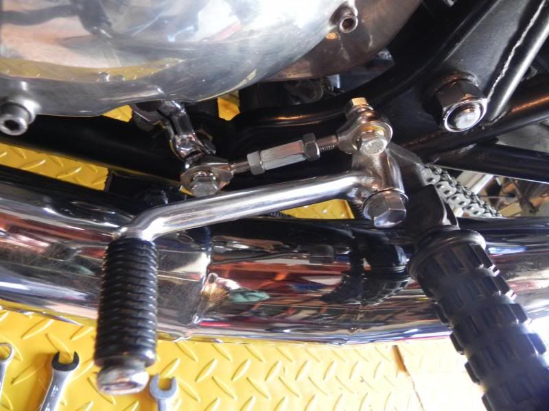

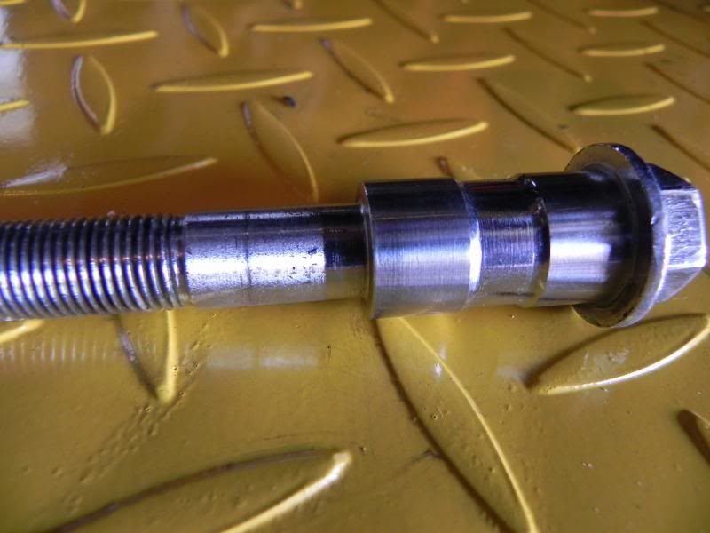

PostPosted: Wed Oct 16, 2013 9:12 pm
poltergeist187 wrote:
I like it. Do you have any photos?
Try this for zero slop!
Machine the pivot
Sleeve the shifter (brass)
Heim joints and threaded rod
Install and love it
