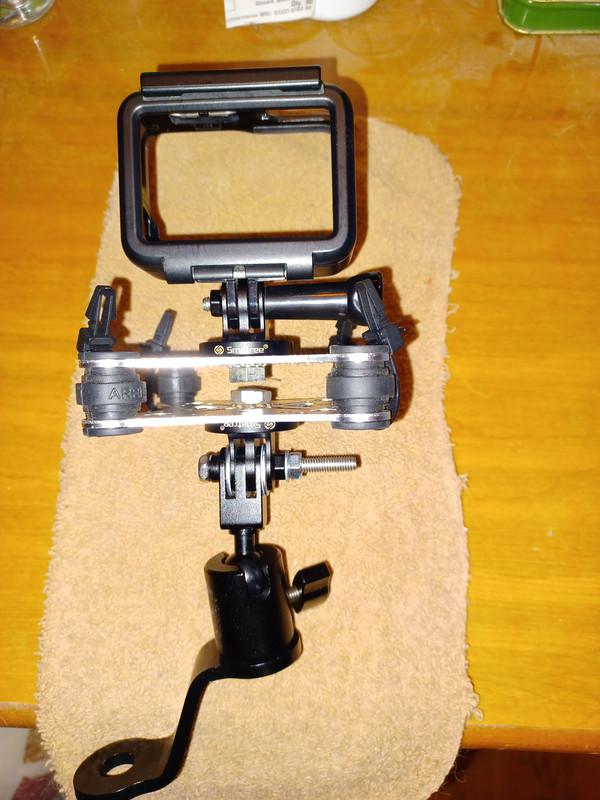

Frank B gave me a camera mount for my Go Pro a while back and I tried It out on the handle bars using the mirror mount hole and got a lot of what I am told the drone guys call jelloing or shaky video. So I have been watching some how tos and doing some research. I bought an anti-jello mount made out of aluminum as I don't trust Chinese carbon fiber which is what most of them are made out of for $7 shipped and two tripod mounts for $12 each shipped. Then I made two small studs out of a 1/4 20 bolt and red loctited them into the tripod mounts. Then I used serrated washers so they would dig into the aluminum and tightened every thing down. Then I faced off the ends of the studs a bit with my bench grinder to make sure there was enough space so they couldn't touch and installed zip ties loosely at the corners in case of grommet failure. I hope to test it soon.

I would call that a success!
