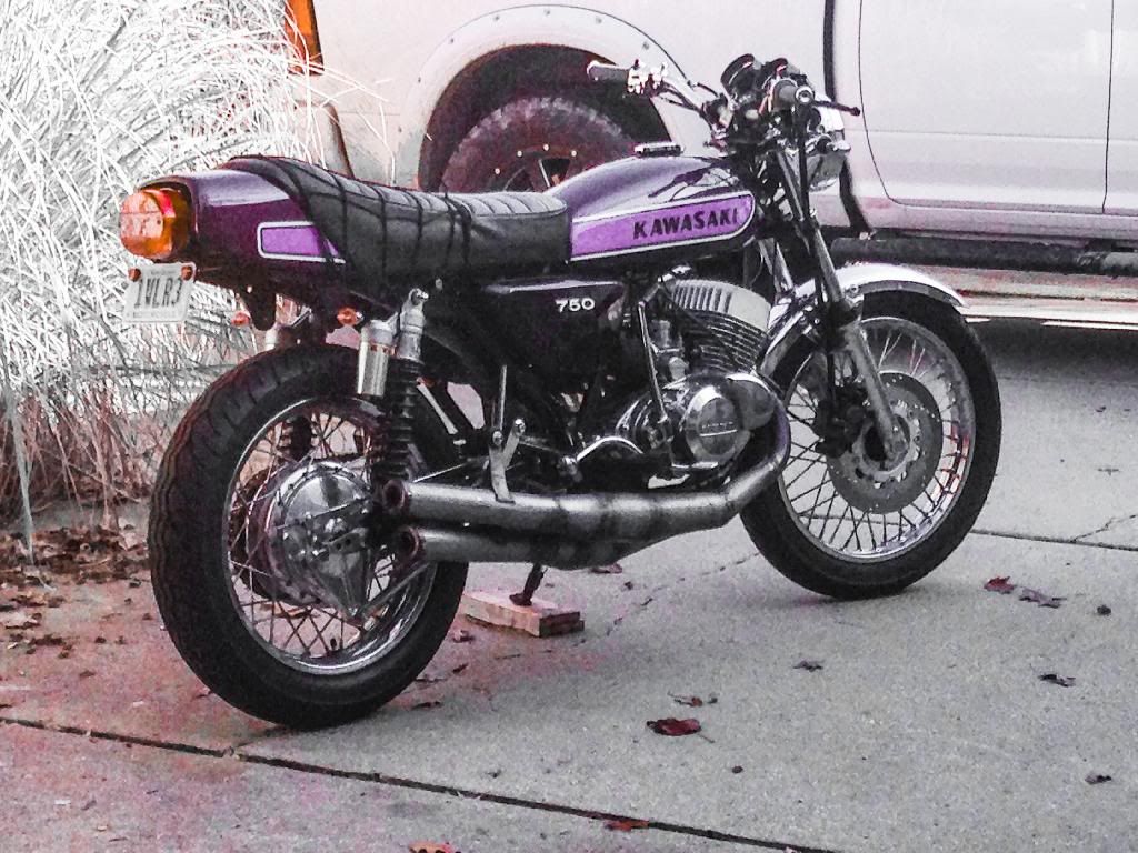

Just keep reading posits and ask a general question for any services you need. If you can't find an answer just ask, this board is great and the veterans are loaded with knowledge and resources. go here for everything you mentioned previously and MORE, http://kawtriple.com/mraxl/howto.htm
thats my bike that i rebuilt and fine tuned with all of the tips that i had NO knowledge of when i joined a few years ago.

I have seen other pictures of your bike.......You have it looking really good........The controls look good polished........Are those the new FBG pipes, look a lot fatter than my old FBG hydro formed pipes.......I'll bet they work well........what kind of shocks ?
Why did you mount the EX caliper on the right side ?......did you get a right side caliper?.......I know it does not matter, kind of like to keep mine on the left
THX Phil

went with the right side set up for ease of routing and it was nice and easy. works so much better than stock with the EX setup.
Yes they are FBG pipes, really happy with them now that i have my jetting sorted out. sounds really nice to my ear, deep and solid….not tinny at all.
Controls came out good, they are a set of rental bars honda dirt bike bars that put me in a nice position on the bike. rear shocks are from a ZRX11 or 12 KYB's Can be picked up for a nice price and work really well.
