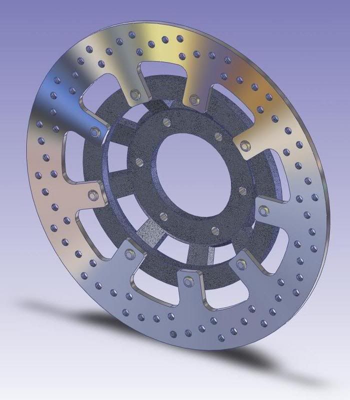

What? NO HOLES?? If it is done right, you can get 72 holes in one disc, with a fair reduction in weight. Do the Moo Mod as well, even NICER disc.

Yup, I plan to put holes in mine... Even though the thinning removes much more weight then drilling holes, the holes look slick imo.

Am I crazy to think that it's getting to the point that fabbing a new plate out of modern materials might be faster than modifying the original boat anchor?
Seems like if you're running a modern caliper, using something as thick and hard as the original is more trouble than it's worth. I'm also asssuming that removing the rivets and re-attaching to the hub would not be too big a chore.
It's too bad that the guy on eBay that drills them for something like $65 doesn't also cut out the squares like John's design.

Wrong correct H2R drill pattern. Hole sizes are also too small. But, you did have to be the one that stayed in the race shop after hours, and drilled them first bunches of discs, to get the pattern and hole size correct, and have Bertea Corporation engineer Dave Hussey next door at Morris Mags working late at night, to get that first pattern, taken from a 1965 Porsche Can-Am car.
Then, you should make some sort of story up that the reason YOUR pattern works better than that original 72 hole pattern is (fill in this blank).
It really isn't in the doing, it is in the story.
And, on the Morris Mags I ran on my stolen street H2A, Morris had bearing adapters that had the hubs for the discs already on the adapters, so, I had to drill the rivits out of the stock discs, then, bolt them to the hubs with countersunk Allen screws. Later Morris mags used a bearing adapter that only held the bearing, and sandwiched between the wheel and disc hub, no disc adapter. These guys were patterend off the original 1976 KZ900LTD Morris wheels that Eliott sold to the Kaweasaki factory in droves.
PostPosted: Fri Dec 16, 2011 9:38 pm
Hole diameter is just calculated by the area of the 2 circles the diameter of the hole, to be equal to the area of the cylinder wall of the hole.
I just personally don't like holes in discs......
I will draw the name Monday......... :thumbup:
It might be a good idea Jim, if you had the right material, getting one laser cut would be pretty quick and relatively cheap... My only concern would be my ignorance in picking the correct material with ideal grain structure to minimize warpage and material pickup...
Maybe the answer is a bolt on existing rotor to a custom hub???
Sorry for the highjAck Moo... I wish it were a S series rotor, I'd have my name in the hat for sure! 8-)
