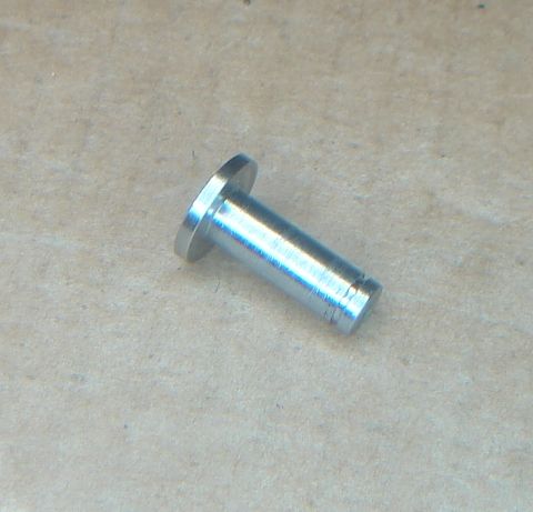

Could you take the C clip and see if a 5mm screw ( same size as the oil pump bolts ) fits INSIDE the C clip?
I'm ready to start with the pins now. I have a piece of 1/2" diameter 304 stainless steel and borrowed a carbide insert grooving tool for the C clip.
Jeff

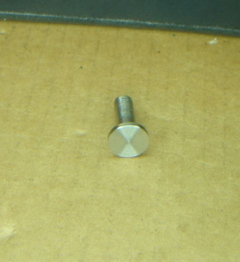

Made one while I wait for an answer on minor ( inner ) C clip diameter.

5mm screw fits inside clip, 6mm does not.

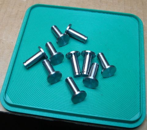

I just got done a total of ten, mach3restore gets six and kawi3cyl gets four.
Jeff
