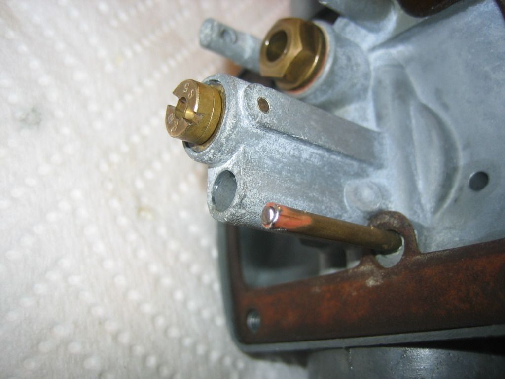

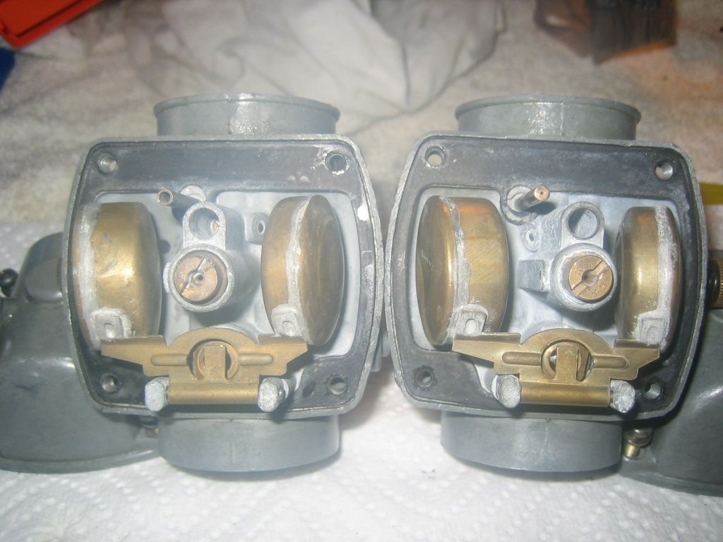

The next thing I did is a bit weird but the more I thought about it, the more I believed it would fix my problem. I had nothing to lose because at this point I was shopping for replacement carb(s). On another thread, long ago, I posted the following picture and asked if I should worry about the missing plug at the bottom of a tube in one of my three carbs.
See the one on the left has an open tube and the one on the right has a plug with a tiny orifice in it.
I was told that it has nothing to do with my mid-range problem and that it was part of the enrichment system. I said, Duh, you're right. It looked like the worst case is that it would deliver too much fuel when using the choke on that one cylinder. I continued my build without thinking much about it again.
After a few more failed efforts to get the bike running right, I took a few days off and just thought about it some more. I got it down to the problem being in just that one carb. The only difference that I can see is the missing plug. How can that affect the operation of the carb? I think that all is well at idle. It will idle all day long. When I start accelerating that cylinder gets all sloppy and the bike runs like crap unless I run it at full throttle all the time. It does not like partial throttle operation. I now suspect that as engine speed increases, inlet pressure drops enough to start sucking fuel through the enrichment valve. The enrichment valve is supposed to block the flow but without the orifice in the tube there is atmospheric pressure pushing fuel out of the bowl and flooding the enrichment valve. Enough fuel gets by to cause a super rich condition. With wide open throttle the condition becomes less problematic and the engine runs OK.
So I plugged the bottom of the tube with a piece of stainless rod that I silver soldered in place.
There is no orifice drilled through, but I just wanted to get rid of the big hole in the tube.
I did all the normal carb adjustments and then took it for a ride. It runs great.
I will go find that other post on the question about the tube and put this information there so others might not fall in this trap.
