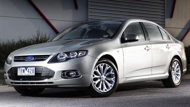

Falcon production ends in Australia next year, I think - They are all buying small cars, or S.U.V's. http://www.curbsideclassic.com/wp-conte ... 2013-w.jpg
