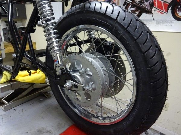

Some rear wheel pics, it has new bearings, seals, rims, spokes, cush drive rubbers, sprocket, and sprocket lock washers. Sprocket nuts, among many other fasteners get a fresh Zinc replate.
I like the look of the VHT Universal Aluminum and a Glossy Clear over it. It will look really good once the motor of the same color gets installed. The motor will be VHT only and no glossy clear.
