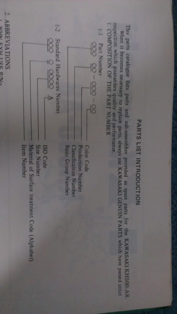

Taken from the front of my KH 500 parts catalogue
Apologies about the orientation but on my mobile and it won't let me edit it
Gary T

Thanks, Gary. That was in some of my material if I had just looked!
So "n" is material finish. Does anyone know what the "n" codes represent in terms of finish?
That must mean that "xxx" codes contain pitch info as well as head type?
