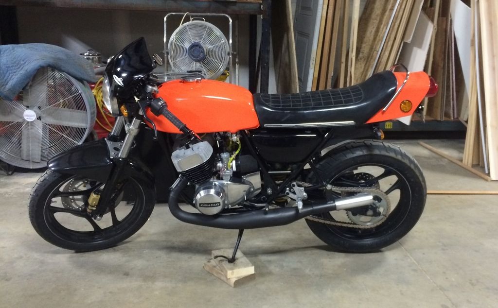

I simply LOVE the look of your bike. You really belong to the upper class custom H2's builder with this one. Congrats!!!!!
Jørgen
 Post subject: Re: Inherited H2 project
PostPosted: Mon Mar 16, 2015 12:47 pm
Posts: 971
Location: Eagle Wisconsin
Thanks Jorgen! :D
But I have to give a lot of credit to my cousin, it was his vision, I received 95% of the parts from him, many of them completed, so I was just an assembler and made a few small mod's along the way to get it to fit together.
Looking forward to the first real ride for sure :thumbup:

Took it out for a proper ride yesterday. I haven't ridden a 2 stroke in years and as far as triples go I used to drive a S1 250 many many years ago when I was a kid.
This is a very different bike to ride than anything I have previously ridden, Its like riding an angry Bee! :twisted:
And all the talk about the vibration had me worried, but it's not that bad at all, longer rides may prove different but my Old Suzuki Gs is just about as bad.
Still a ways to go with jetting and its hard to tell if its rich or lean yet because I don't know the characteristics of these bikes, but getting quite a bog starting around 4 grand to around 5500 around 1/4 to 3/8th throttle, but then it really takes off and pulls pretty hard and seems to want to rev forever. Im guessing rich in that spot but I have to go thru all the steps before I will figure it out.
So jetting needs a lot of work, and the tires, "new" back in '97, seem rock hard, until they are replaced I will reserve judgment on handling, Im not a great rider anyway so I may never know.
The shifting is another thing that will take some getting used to and I hope I don't bend a fork :roll:
The all up shifting throws me a bit and the shifting is so light its hard to tell when it shifts up or down!
Also it is very difficult to hit neutral and if you don't get it in natural while its rolling forget it, shut it off and it clicks right in to natural. The clutch does not drag and feels real nice, smooth with good feel. The trans was done by MRE, undercut, ect. I checked the shimming per the resource site when I installed it and it was right, and the forks looks great so I assume thats how it shifts and I need to get used to it.
Brakes are nice, stops well with good feel, not one finger but I would hate that as I am a ham fisted rider anyway!
Cant wait to apply the decals and sort it all out! I moved it to another shop for now where those things can take place.

Glad you are out having some fun! As far as the bog, rich is studdering or 4 stroking, and lean is where it goes flat or bogs. I would raise the needles first to see how that helps. You can also turn in the air screws a 1/2 turn to test. As far as shifting, you will get used to it, just make sure you hold the shifter in the total up position until you let the clutch back out. And with under cut you basically have to go into neutral when rolling.

Don't know what decals you have for that bike, but it certainly looks good without any, at this stage! Also, another convert to the slick-shifting H2 gearbox. :thumbup: The jetting problems you have sound about normal, and you and your cousin have done a great job to get this far, so you will sort it out. Cheers!

I was just out riding raised the needles it was worse dropped them and it is better but I certainly need to start from the beginning with the carb tuning! Its not terrible, I assume from what Ive read here the reeds help with jetting a lot and its not as fussy.
