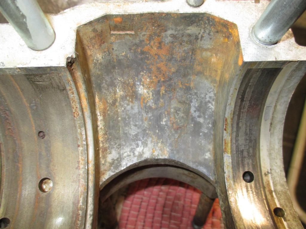

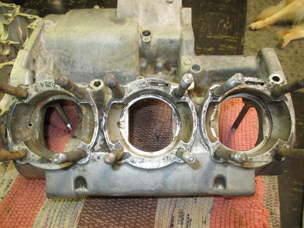

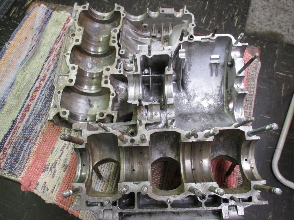

I just spent 2 hours wire brushing and gunking these cases.......should have seen them before :shock: ........obviously they are going to need something a bit more industrial strength..........what is the best method to get these prepped :?: .........have them hot tanked ? or can that warp them.........or have them bead blasted and what about the steel bearing bosses ?......then run a die over the studs (may have to replace one)

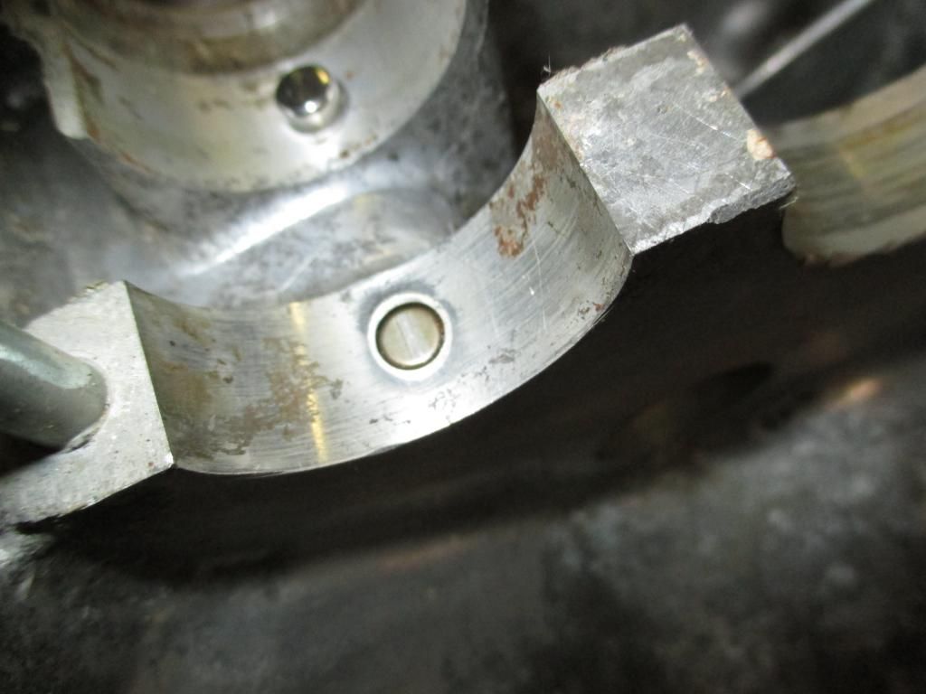

They also have one pushed in pin on the needle bearing of the trans input shaft.......how do you get those out ?

Bead or vapor blast cases... Avoid bearing surfaces.
Drill behind pin and push it up http://www.kawasaki.org.uk/saved/pins/
