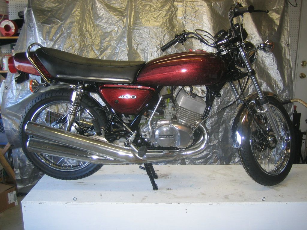

Here is what my S3 looked like right before I took it off the build stand. Since then I added gas cap, mirrors, and chain guard. Maybe a couple of other little things - I forgot.

I really like the paint, and the lack of decals. :D Is that the kind of paint job that you drag plastic wrap through?

Yes, I think the paint is done with plastic wrap. The guy I bought it from was a custom paint guy. Not a mechanic.
Over the winter I plan on getting new pipes, paint and seat upholstery. Then it will be almost entirely finished.
