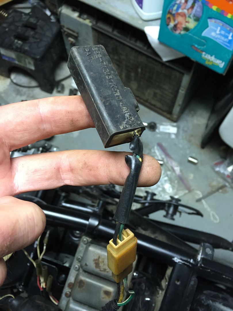

Yep.....seems I saw that thing in a parts box and remembered it had a 3 pin plug. I'll be digging it out this weekend and sorting the wiring. :thumbup:

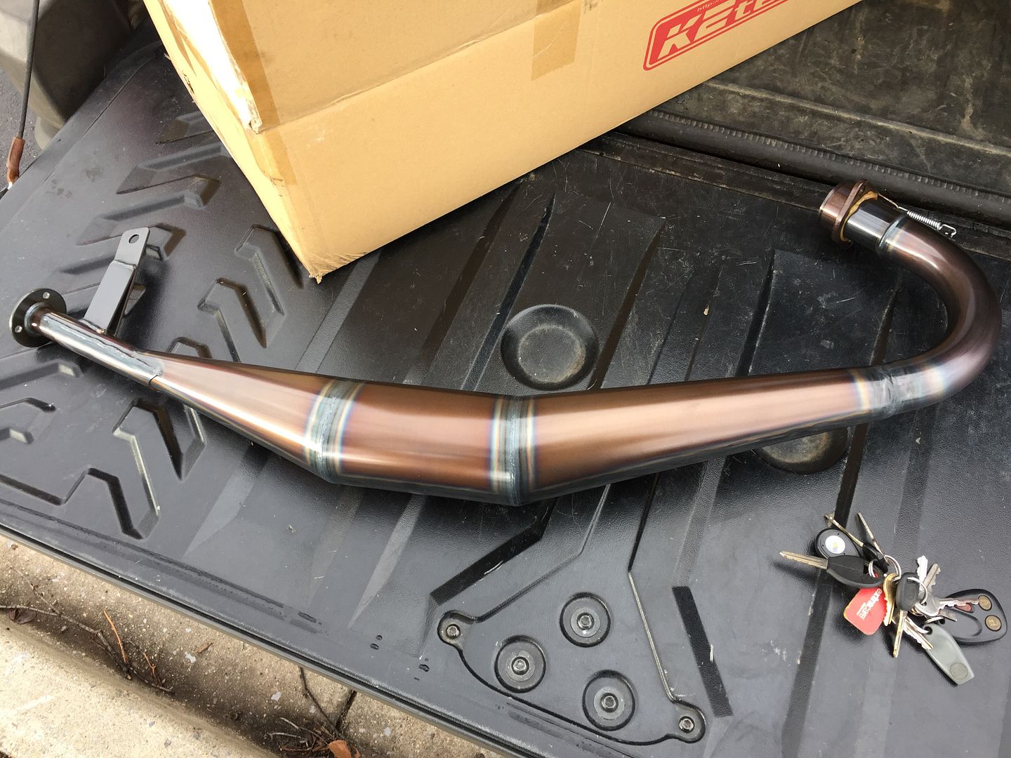

Here's a pic of the coated chambers. They look great. Interesting enough, I didn't notice the cylinder flange wasn't removable until today.

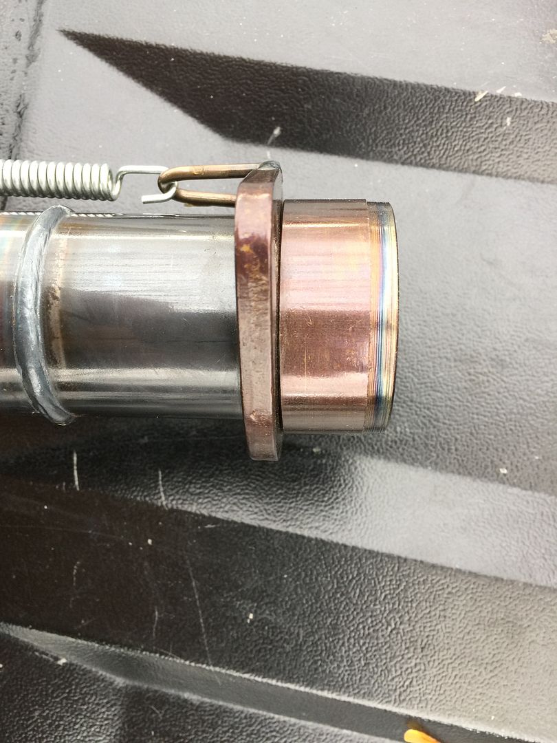

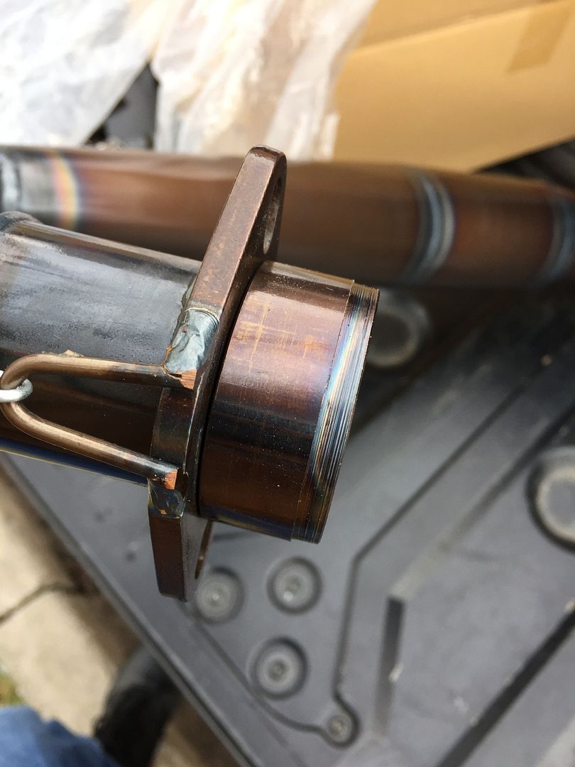

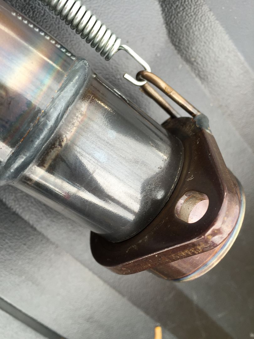

The collars that bolt to the cylinders are loose. The top flange is solid. Once the pipe is bolted on, I don't see a need for the spring.....unless I'm missing something. I tried sliding the flange itself off but it wouldn't come off. Only the collar rotated. I'll look at it a little closer in a few minutes and get some pics of the assembly. :thumbup:
PostPosted: Thu Dec 31, 2015 12:05 pm
I looked at the top and it looks welded solid except for the collar. I twisted on that flange good and it doesn't turn. Some close ups.

RODH2 wrote:
So if the flange holds the pipe......what does the spring do.......??!! :think:
My two theories:
1. to just look cool
2. most likely they decided to just weld the pipes up solid and not hear about oil leakage. And retrofitted the pipe already built.
I would definitely rubber mount these guys, they won't last long with a hard front mount.
PostPosted: Thu Dec 31, 2015 7:58 pm
The old J&R's were flange mounted like that, (not to mention Kawasaki's pipes.....) I ran a set for years before they started to crack - by which time the whole bike was starting to crack! :lol: Any Advocates for hard mounting (early H2) pipes here?? :think:
