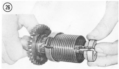

I think I have confirmation: I blew up the pic looking right at the spring and can see the shine of the entire shaft between each coil, without the guide piece there.
Kon-Tiki: I see how the piece is kind of peeking out the back and doesn't appear on mine.
Thanks for the input everyone!! Live and Learn!! Not discouraged.... minor setback is all and I'll just handle it!

That was what I needed. It would be obvious as in Kon Tiki's photo. Guess my Saturday is spoken for! Thank you Zambia and thanks to all for your valuable input!!
