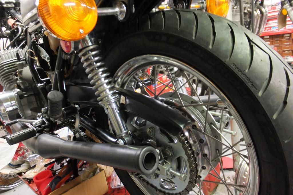

I have the 3.50 x 18 rear but with tire mounted it's real close to chain , believe I'm running a 2.15 x 18 front. I had to pull the chain guard off of bike with the wider rear
PostPosted: Wed Dec 25, 2013 12:20 am
Posts: 316
Location: Tampa Bay, FL
Same rim sizes I'm using on my H2C with no chain guard issues...

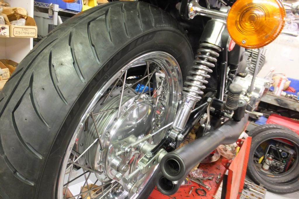

What size tire, 130?
PostPosted: Wed Dec 25, 2013 1:25 am
I run a 130/80-18 on a 3.50 rim, it's close, but no clearance issues! :D
