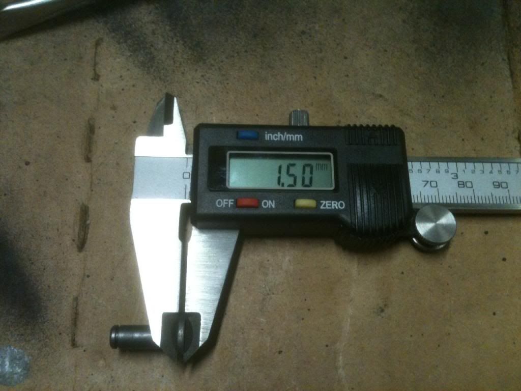

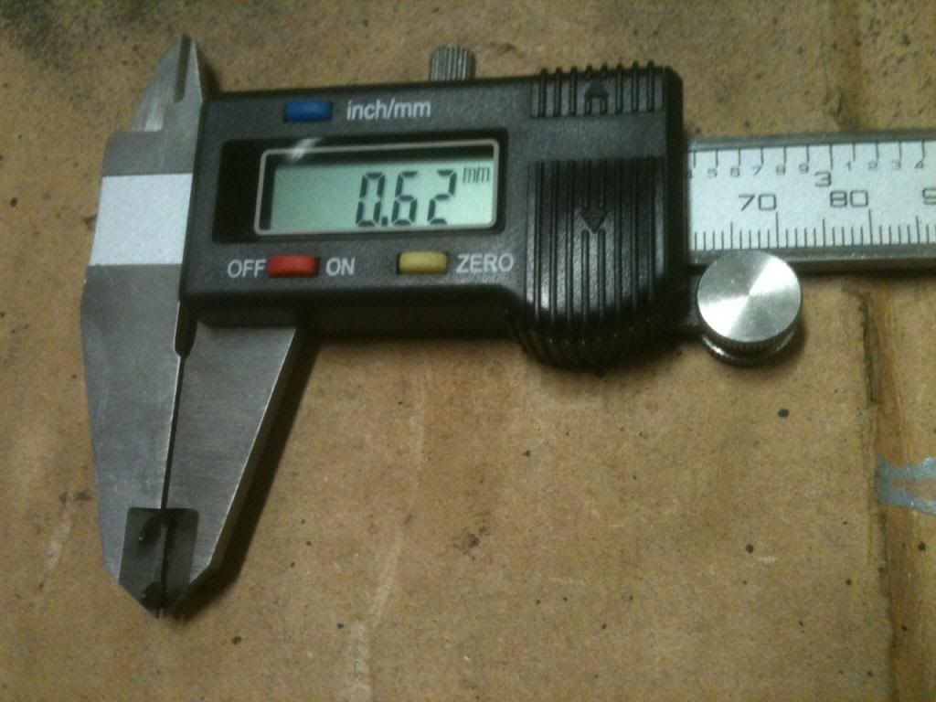

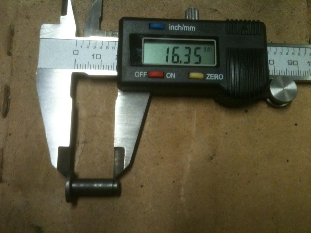

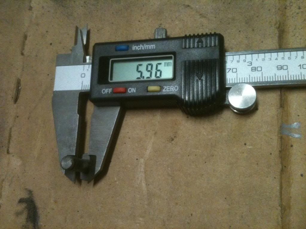

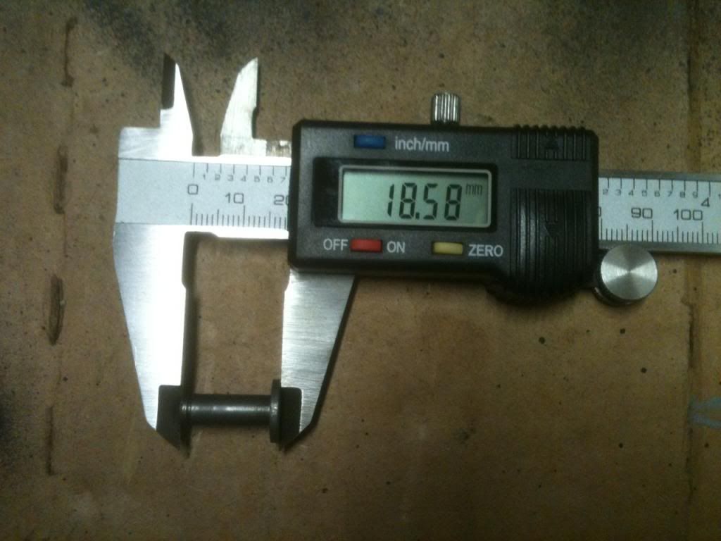

Using HB calipers:

Using HB calipers:
That's the gems I need. I need 6 of those little gems.
