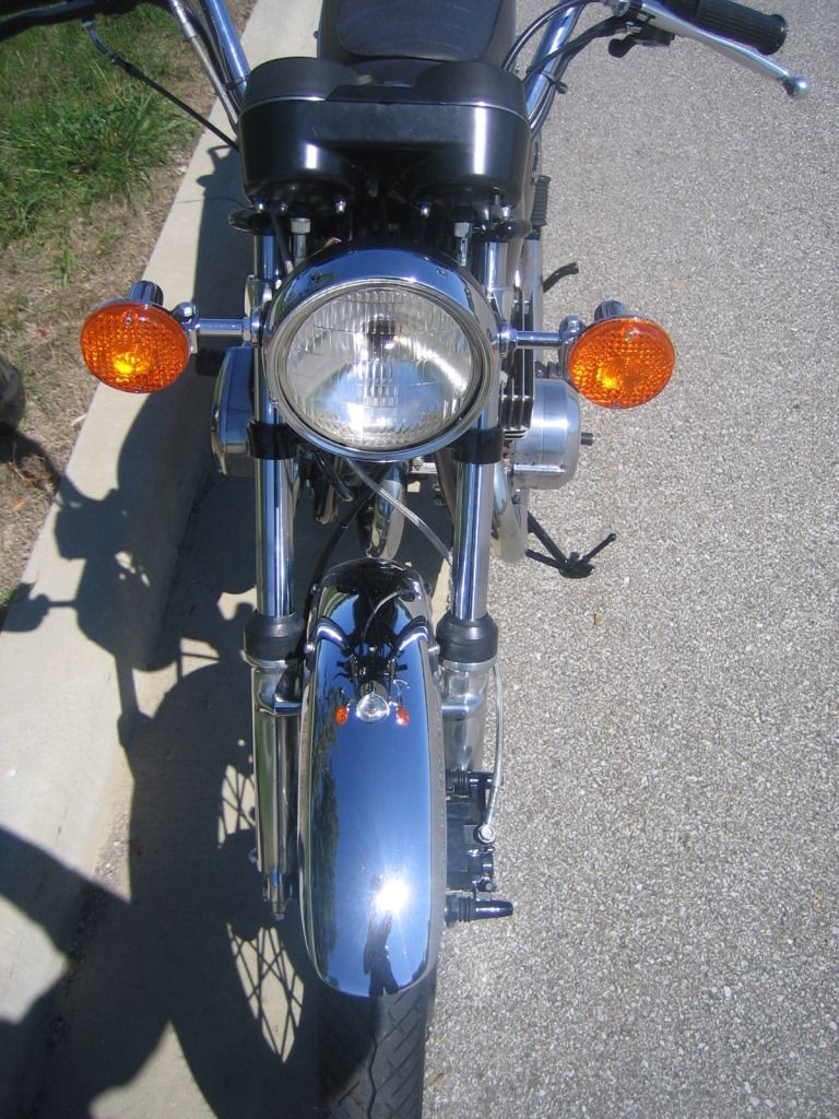

Congrats Rotor bike looks awesome :thumbup:.
I like those front turn signal mounts I think I'll do the same :thumbup:
