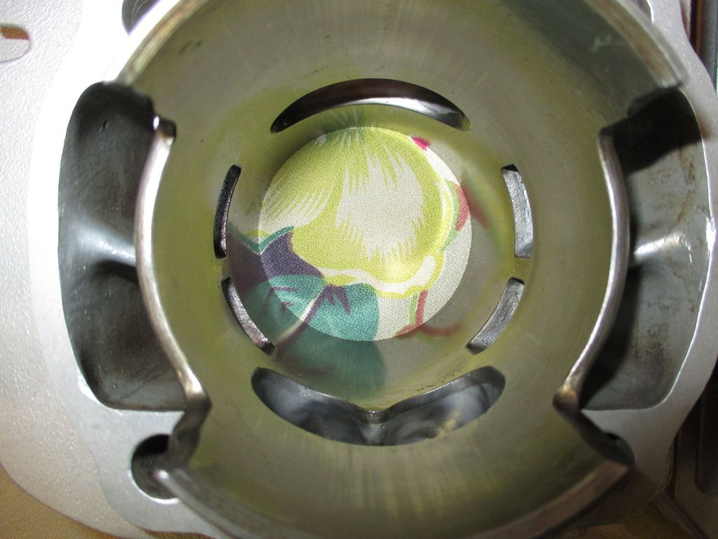

OK then........so the very early cylinders............with the tall and square cutaways.........known to be the hottest cylinders............when the transfer just starts to open, the cutaway matches the piston and is open starting at the same time........anybody measure this with "Wossners".........I am not sure, but I don't think the Piston cutaway is not as tall as the early stock pistons were..........I am guessing from memory, but I thought they were "In between" the Early versus B\C shallow pistons
Also, I have heard that the liners and ports are a different configuration on the early 71 square cutout cylinders.........the transfers are more forward towards the EX port.........the Intake is larger
John raised mine quite a bit on my mild B\C cylinders as you can see, to match the "Wossners".........whether at BDC or when the transfers start to open, I don't know .............this definitely helped it breath with the VM34's and really made it run good............the modified B\C cylinders do have plenty of "Meat" left as well
