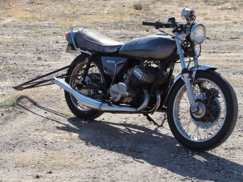

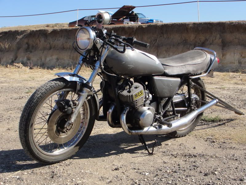

These pics were taken at a car show that was put on by a few friends on September 25. I actually won a prize for "Sickest Cycle". That is a good way to describe this bike! It may not be much but it made me feel alright! 8-)

I really wish I could get the jetting sorted out. It has VM34 Mikunis. The top end feels awesome and it pulls like a bat out of hell. The low-end and mid-range however leaves much to be desired... :x
