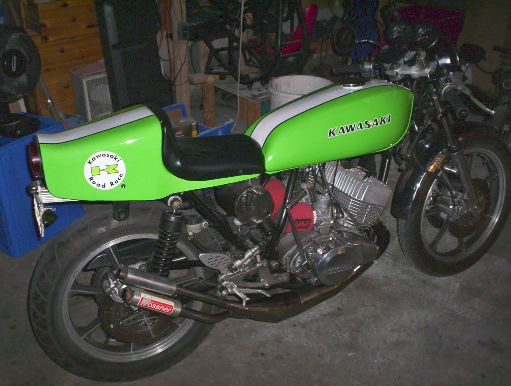

Thought I'd add my bit here, I bought the paint from a friend who does it for a living, he gave me the tips on application, and I bought a $50 HVLP spray gun. Turned out better than I envisioned, total supplies cost around $200, plus my free labour. ;)
Rattle can primer
2K White base coat, base/accelerator/reducer
Green coat, base/reducer
2K Clear coat, Clear/accelerator

scully, You are da man.
i am defo going to get a better gun and try again.

Ya got a run under the 'I' and those head bolts aren't original!!............ :lol: Just kiddin, that is a great job, can you do mine for me? [I'm a spray-painter!!]

Nice, Scully. You gonna tell what paints you used? Quite a variety of "right" answers, and yours looks mighty fine. :thumbup:

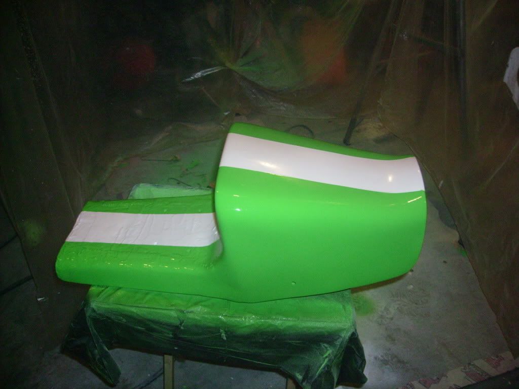

the top pic is HOK So Blue over a white base coat and HOK UC35 Clear....no wet sand or buffing needed....just careful spraying with a craftsman spray gun.....
he lower pic is the paint code from MrAxls we page in PPG.....using a gray primer and cleared with..god I forgot...
The head bolts...are custom and stainless from a board member a while ago, polished by...me :-)
buy good paint and read the directions well....and make sure your paint area is secure of dust and debris..and never rush....mid 70's temp works well too.....
and tries to paint in pairs too lol
