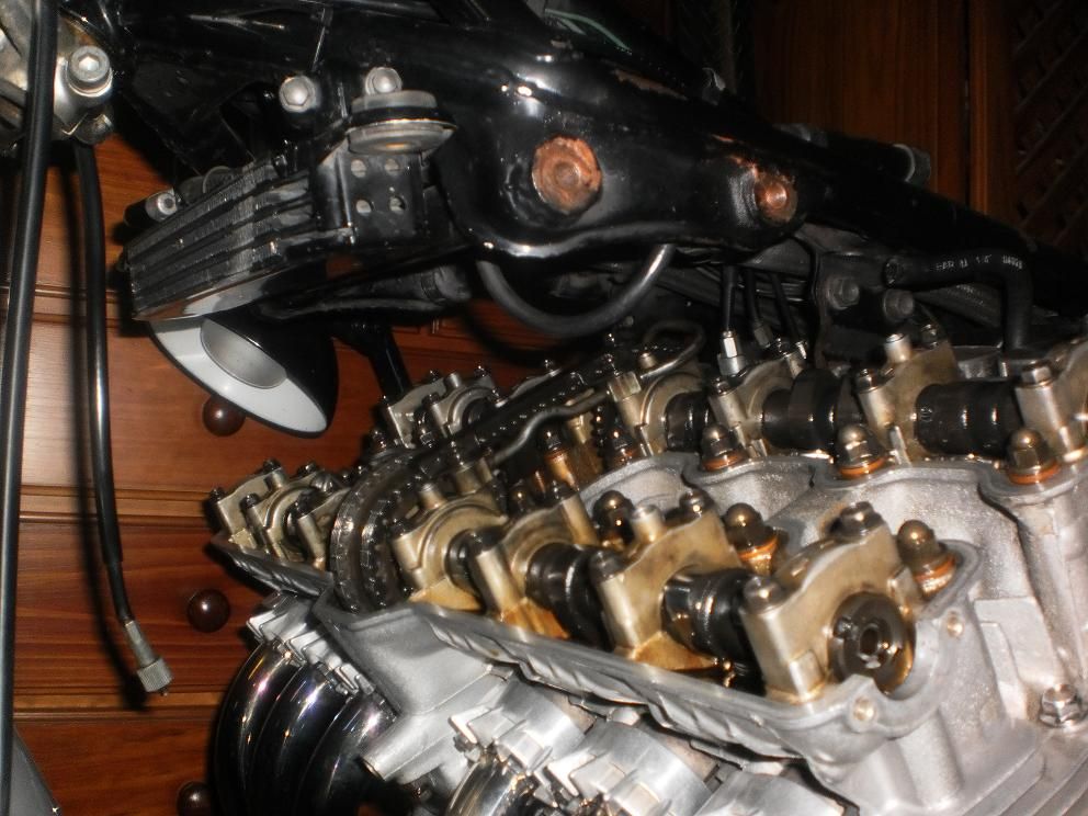

After 25 years of ownership I decided to tackle the dreaded valve adjustment on my CBX...
It's actually not as hard as it looks!

I also bought Mike Nixon's "Adjusting the CBX Valves" booklet, a quality set of feeler gauges, a good digital caliper, a MotionPro valve bucket tool and a nice set of tweezers. I'm now waiting on six shims to arrive. The guy who supplied the gasket & MotionPro tool is a CBX specialist & he stocks 1/2 size shims, for those of us who are anal!

I was getting the valves checked/adjusted in all that time! However, the only guy I trusted to do a proper job retired a few years ago. I delayed the job as I hardly ride the bike. Only one valve was out-of-spec (.04). Five others are within the acceptable range, but I want to go a smidgen looser with them.
Trevor
