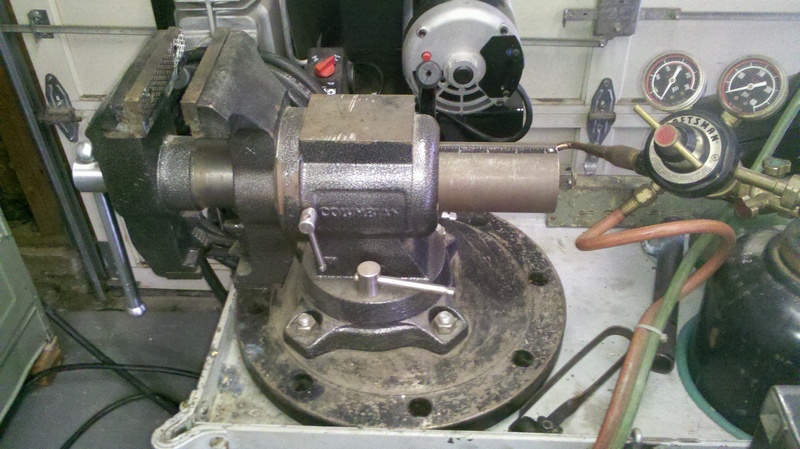

I have a couple of vises I use, a low profile one is bolted on but can be removed, I have a couple of other ones I can clamp on and I have Big Bertha that's bolted to a heavy plate - big enough to hold things but not too heavy to move.
