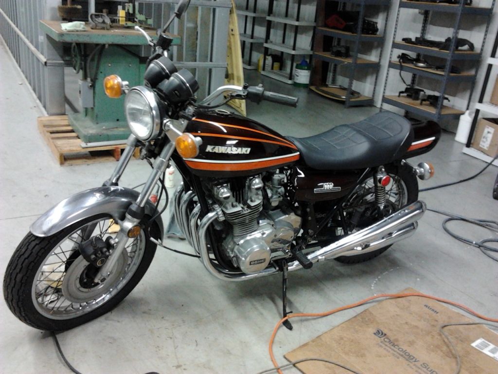

buddy of mine is saying that this is a h2 wheel hub on my 74 z1 project because it is black and brake rotor has 6 bolts instead of 4.. any way to identify

My 74 has a black hub and 6 bolt rotor. I also looked on Google images and found that the early Z1s DID have the six bolt rotor. You have the real deal! ED :thumbup:

Yeah, I thought the early Z1's had the same front hub as the early H2, (same rear too, of course), but the later Z's had the smaller silver hub, which was quite a bit lighter!?

I sold a few on eBay, here is the fitment information I had:
41080-001 Brake Rotor (6 hole)
1972 H1-B H1B
1973 H1-D H1D
1974 H1-E H1E
1975 H1-F H1F
1972 H2 Mach IV 750 Triple
1973 H2-A H2A Mach IV
1974 H2-B H2B Mach IV
1975 H2-C H2C Mach IV
1973 Z1 Z-1 900 DOHC
1974 Z1-A Z1A 900 DOHC
1975 Z1-B Z1B 900 DOHC
41080-005 Front Brake Rotor (4 hole)
KH500-A8 1976 KH500 KH500A8
KZ1000-A1 KZ1000 1977 KZ1000A1
KZ1000-A2 KZ1000 1978 KZ1000A2
KZ1000-A2A KZ1000 1978 KZ1000A2A
KZ650-B1 1977 KZ650 KZ650B1
KZ650-B2 1978 KZ650B2
KZ650-B2A 1978 KZ650B2A
KZ650-B3 1979 KZ650B3
KZ750-B1 1976 KZ750 KZ750B1
KZ750-B2 1977 KZ750B2
KZ750-B3 1978 KZ750B3
KZ750-B4 1979 KZ750B4
KZ900-A4 1976 KZ900 KZ900A4
KZ900-A5 1977 KZ900A5
steve
