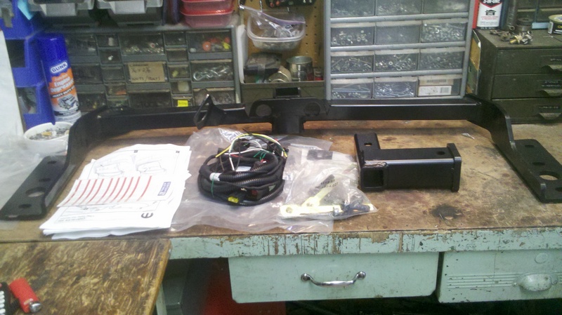

I run down (it's 4pm now) and sure enough it's all there but the bolt bag is torn and the instructions are torn up too (Andrews pipes were missing bits too - is there some higher force at work here? No big deal on the instructions since I downloaded the PDF from Chrysler - but it "looks" to be all there. One thing I notice is the receiver is different. The one I "thought" was coming was an angled from underneath and up to the outside of the bumper - a single unit that's almost a U shape. But it's not - its an L shape (middle bit in the photo below). So I need 'another" regular receiver to go into that making it three parts - The Hitch receiver, the L adapter and a regular Drop (or in my case Raise) bit.
So I get home and notice one of the special nut-on-a-stick holders is missing, one large high-strength bolts (of 6) and smaller bolt are gone... So I run down to Ace hardware (these are large metric) and at the checkout I realize my wallets at home. Run home, run back and run home again, by now it's getting dark.
Doing it myself saves $164 bucks and the instructions don't look too bad. Getting the rubber hangars off the exhaust and frame was the worst without jacking up the car which I did not want to deal with so fat belly me was squished underneath - cars today don't have good lift points or places to get jack stands under.
But I manage to drop the exhaust enough to give a little access to the frame holes, of course they're full of road crud so had to clean them out, still was a work-out on my air-ratchet running the bolts through before trying to mount everything up.
So I need to make a Nut-on-a-stick, it holds a nut inside the frame rail - there's three of these total, very tricky to get these through the hole and over the bolt hole itself... Plus trying to hold the very heavy hitch in place... There's 6 holes on each side and I have 5 of the high-strength bolts and the standard one from Ace hardware. Torque was 75lbs per instructions - of course I just gave as much on the softer bolt as I thought it would hold on the torque wrench - not even close to 75 lbs but it'll all be OK.
The factory wiring harness is great though - it plugs into the taillight harness (no cutting) and has a big sealed grommet where you knock out a fill plug underneath the trunk. The hitch also has a great holder for the flat-4 plug with a cover - up underneath on the hitch - out of the way.
I still need to do the wiring - and then measure the height so I get the correct receiver tomorrow, they're usually pretty cheap anyway.
