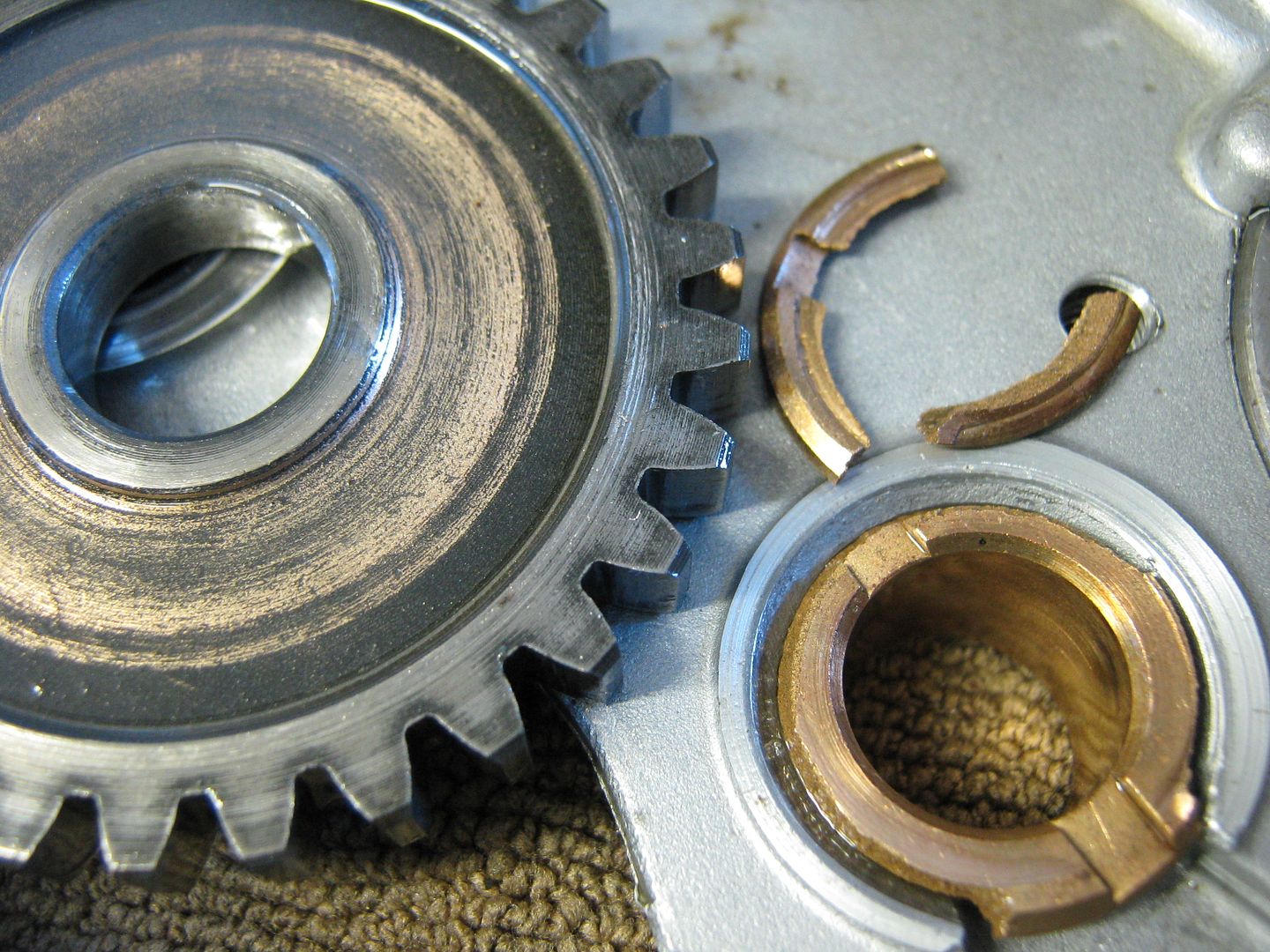

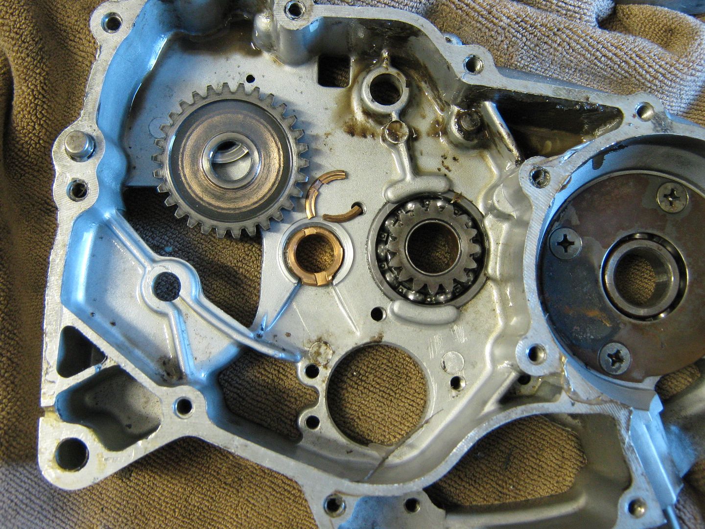

I found the problem, the output shaft bushing(oil galley)is sheared off on the inside. I can't see why it sheared off though. I have one ordered but do I press or pound the old one out and the new one in?, the case is pretty thin and of course I don't want to break it.
PostPosted: Fri Feb 05, 2016 4:27 pm
Glad you found the problem, press and maybe a heat gun to expand the aluminum.
PostPosted: Fri Feb 05, 2016 4:55 pm
You should be able to cut the old one out, and maybe freeze the new one and tap it in.
