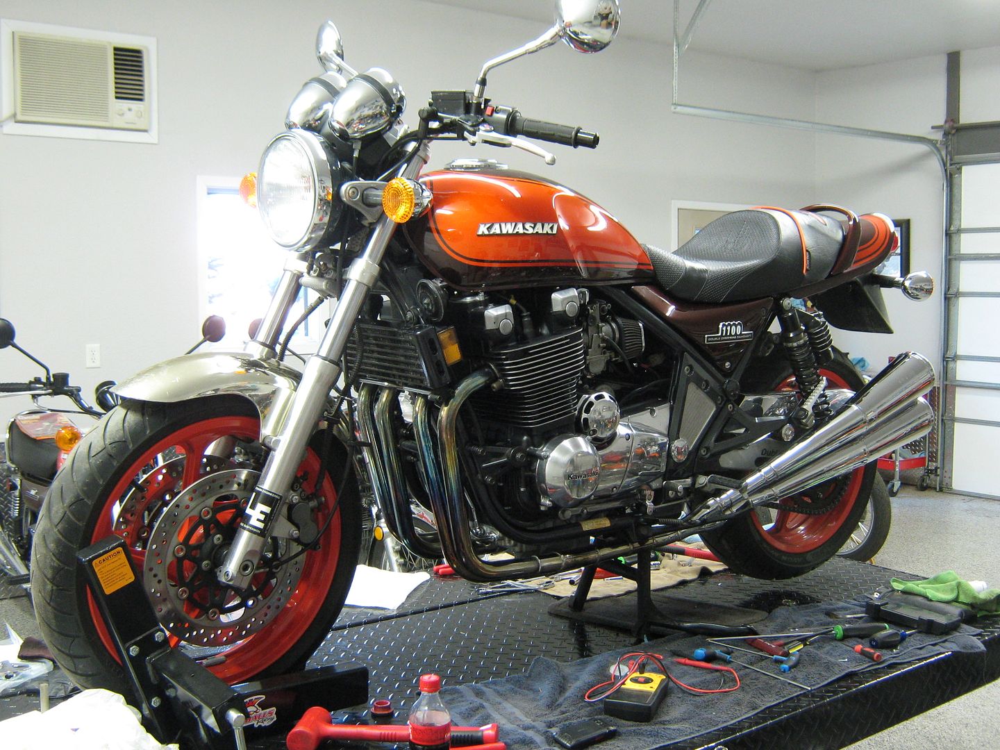

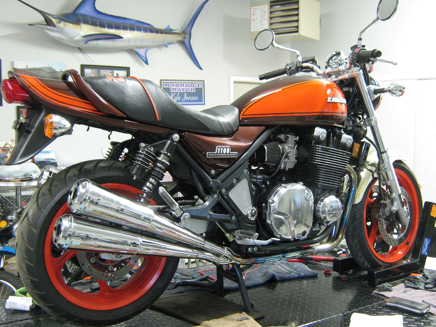

When my friend Kyle bought this bike we liked it a lot and it is a gas to ride but it needed to look more like the original Z1 since it was painted that way and has four pipes. I took the engine out and painted it black and then polished the covers and edged the fins. I think it looks better now.
Before:
Now:

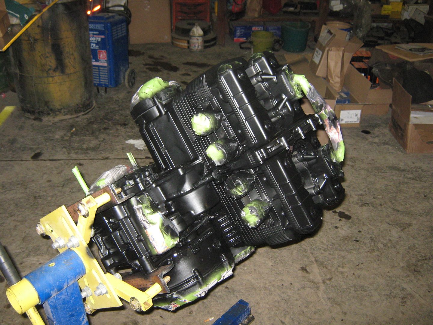

Did you bomb the whole motor in one piece and then fancy it up?

Yup, I even left the oil lines on and masked them. It actually wasn't too bad. I made the mounts for the car engine stand and it made it real easy. I scrubbed it with purple cleaner and sprayed it off with water in a weed sprayer and then wiped it all down with prepsol, tacked it and sprayed the black. I buffed out all the covers and threw it back together. I actually rode it yesterday for a half hour(it was 38 degrees). :D
