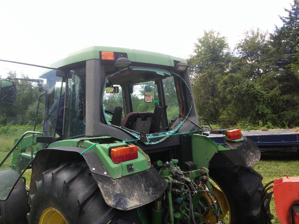

We have no idea what caused this. We thoroughly inspected the tractor and the hay cutter and surrounding area with negative results. Nothing is missing or loose. A new piece of glass is $226 and will be here Friday...
Thank God my partner and his young grandson weren't hurt...

Yep he was cutting hay and heard the glass pop
Nothing wrong with the tractor or hay cutter....

Sniper.

Looks bad :o WOW did it break the fenders too???

No the fiberglass fenders have been broke up for years
Actually we had that thought briefly. But no projectile.

There was a news story the other night about the tempered glass in sunroofs just shattering. It might be the same thing.
PostPosted: Wed Aug 12, 2015 8:33 pm
Yeah, with tempered glass sometimes all it takes is a scratch to make it turn to little cubes. When my wife was working in the display department of a Sears store, she'd sometimes have to assemble glass shelves. Occasionally one of the shelves would just collapse into small bits for no apparent reason.
