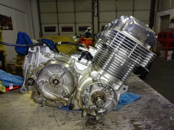

Well the motor is back together. I sure hope I got it right as it is a PITA to take in and out. Everything looks good, it turns over easily, all gears shift though easily. Even tested the new Neutral switch and that is working properly too. Hondamans book helped immensely through the rebuild. It is the little tips he has that make a difference. For instance, I didn't have Permatex #2 for the head discs, I went out and got it. Some pics of the motor done.
Got the carbs backs from Nils and am very happy with the results. The carbs came back super clean and I like the finish. I like the Vapor Blasting look and could see how it could work very well especially for cases that don't get painted like Kawasaki Triples. Restocycle is another great resource for those of us who restore old stuff and I would highly recommend their services.
Got the new face plates in, thank you Marcel, and installed them on the meters, and this time I took it easy on the screw torque.
