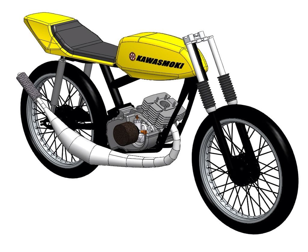

I switch gears on this project from the motor for a couple weeks...
I wanted to go with a flat tracker look but no tail sections small enough for this little frame. I had to go with a bubble... Nothing set in stone while its only in CAD though! :)
I'm also going to design a high pipe, I'm pretty sure that style is going to fit the bike better, just not so sure if I'm going to like the look!
PostPosted: Mon Jan 14, 2013 2:13 pm
needs a bigger tailsection........ ;)
PostPosted: Mon Jan 14, 2013 2:21 pm
That flat tracker seat i wanted was just too big... I'll post a picture later.
But yeah, I agree, too small...
PostPosted: Mon Jan 14, 2013 7:50 pm
PostPosted: Mon Jan 14, 2013 7:52 pm
much better..... :thumbup:
