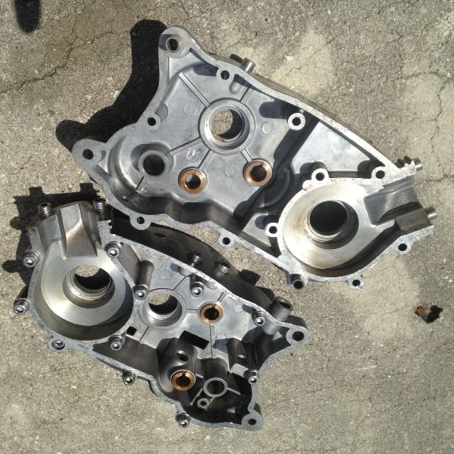

Once I get the cases cleaned, will be heading to the shop to get them and the head bead blasted before re-assembly. Working to source some new rims and replace the original Pirelli tires, spokes are re-useable. Hubs will need bead blasting.

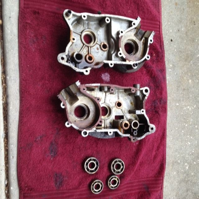

Got the cases stripped for cleaning. New bearings and seals on order. Stay tuned......

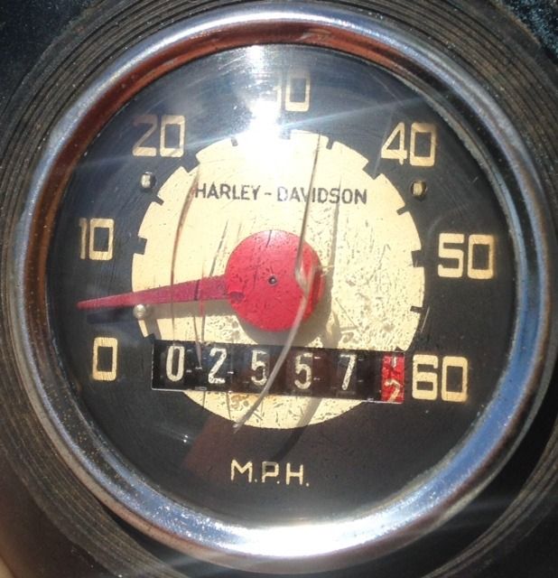

Jet needle and needle looked almost new on the carb, in fact, all the brass was in good shape but the odometer only reads 2,557 miles, no where close to the miles Jim has on his Guzzi.

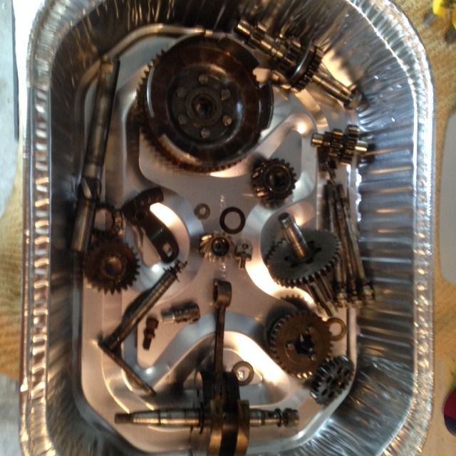

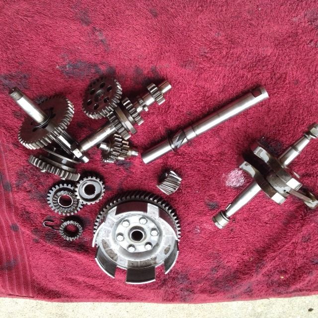

Update on progress......
Bottom end parts cleaned......
Cases cleaned and ready for bead blasting......

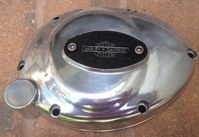

A little buffing and paint work on the side covers......
Less than 60miles/year :D
PostPosted: Thu Mar 31, 2016 4:19 am
60 MPH speedo :!:
