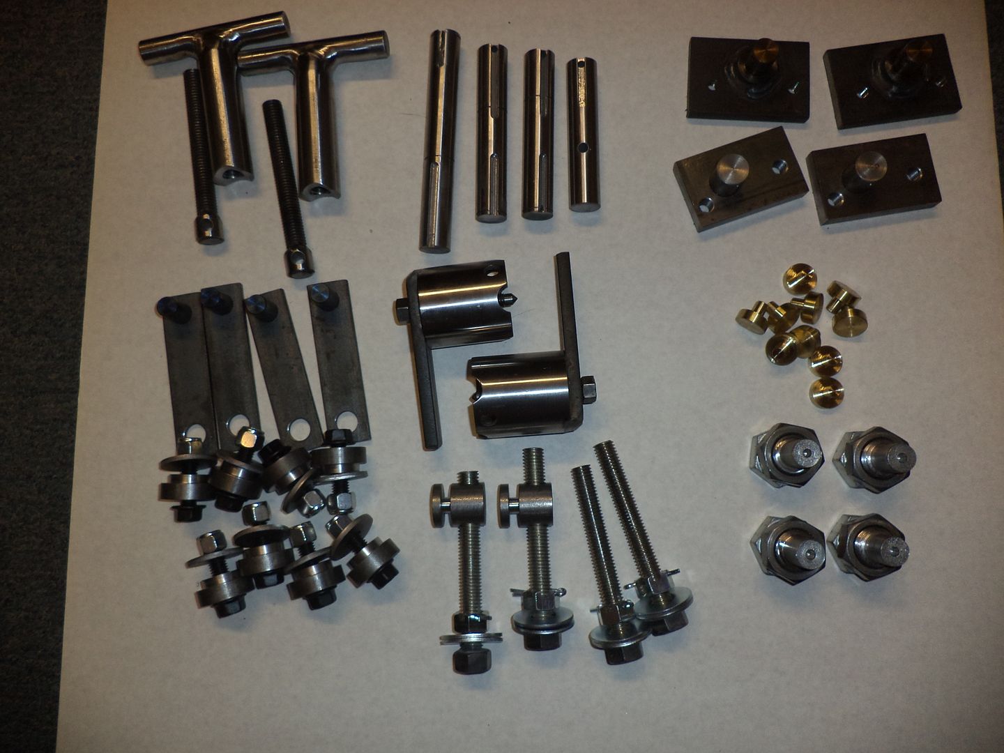

Top pic L to R
(T) "T" are tiller adjustment handles with threaded rod the chain goes on. Precision 3/4" shafts for gear boxes. rear lift attachment brackets
(M) quick attach brackets , PTO pulley pullers, brass PTO buttons
(B) solid motor mounts w/ hardware, snow thrower belt adjustment bolts ( left hand 1/2-13NC ) , & Frankenstein bolts to attach rear lift

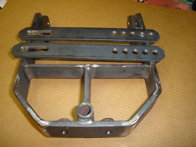

bottom pic is my design of a sleeve hitch adapter so you can use a mouldboard plow on your garden tractor
