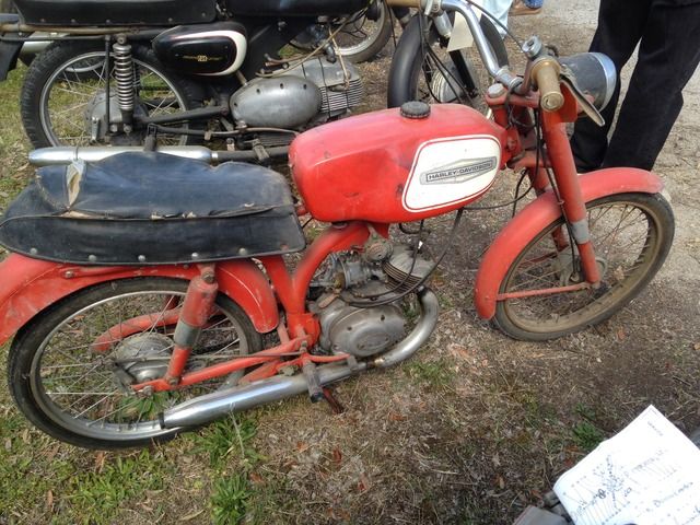

I felt completely overwhelmed having $2K in my pocket until this 1966 HD Aermacchi Legerro 65 hit the block. I had to have it, it was in good shape, and my wife (the pit bitch lol) said go for it. I snagged it for $700 and felt like a king.

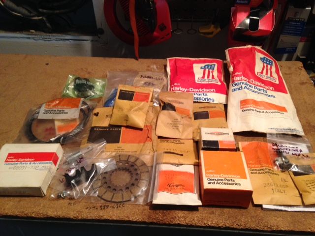

Been ordering a ton of NOS stuff to restore it and will keep this thread going with pics. Just struggling with time to work on it, just got back from the races at NOLA in New Orleans, rain, wind, sucked!

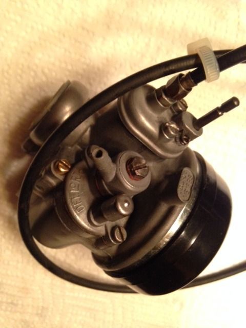

Gotta love those Dellorto carbs.....

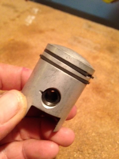

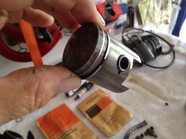

Weed Whacker piston.....

there is just a weak point with Dellorto, carbs parts wear out very fast peculiar needle and jet needle, so change them often and have replacement parts in stock

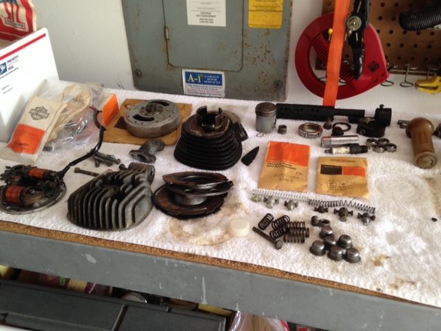

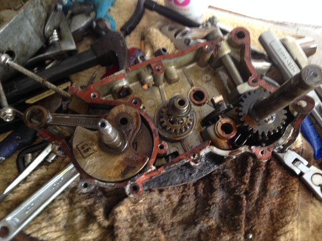

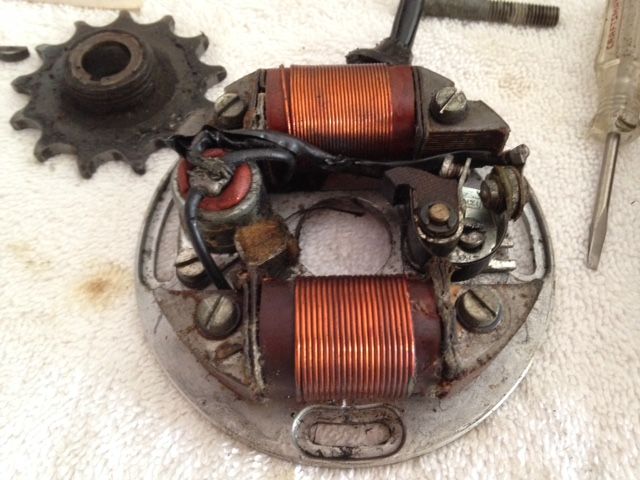

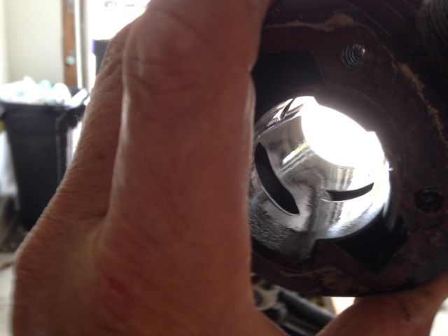

Started the teardown of the motor, was very clean considering the age. Both crank bearings and the mainshaft and driveshaft bearing will need replacing, have them on order. Will put in new oil seals all around. Piston and bore looked good. Will need all new (3) friction plates. Bronze bushings on one side for the counter and drive shafts but they seem to be in excellent shape. Good news was the coils and contact plate looked clean with no corrosion. I have new points which will be installed. Also will need new sprockets, they too are on order. Want to try and get this resto done before I head to the races at Gingerman and Road America in June. Will keep posting progress pics on this thread.
