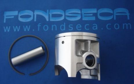

Can you post a pic of the old piston Dave?

Dave C sent me this. I would put the hole in personally.

PostPosted: Mon Jul 15, 2013 2:18 pm
According the the North American 2 stroke site, the TZ 750 does rotate backwards.
But the main thing to look at is the piston pin location, The TZ pin is located low in the piston. So the piston is more stabilized in the bore as far as piston rocking goes. I wouldn't even think of doing the crescent cut out on an H series motor, the skirt would be way over loaded from the higher pin location. Plus the guys that actually have raced the Yammi twins in the last decade, found excessive damage from high cutting the crescent.
