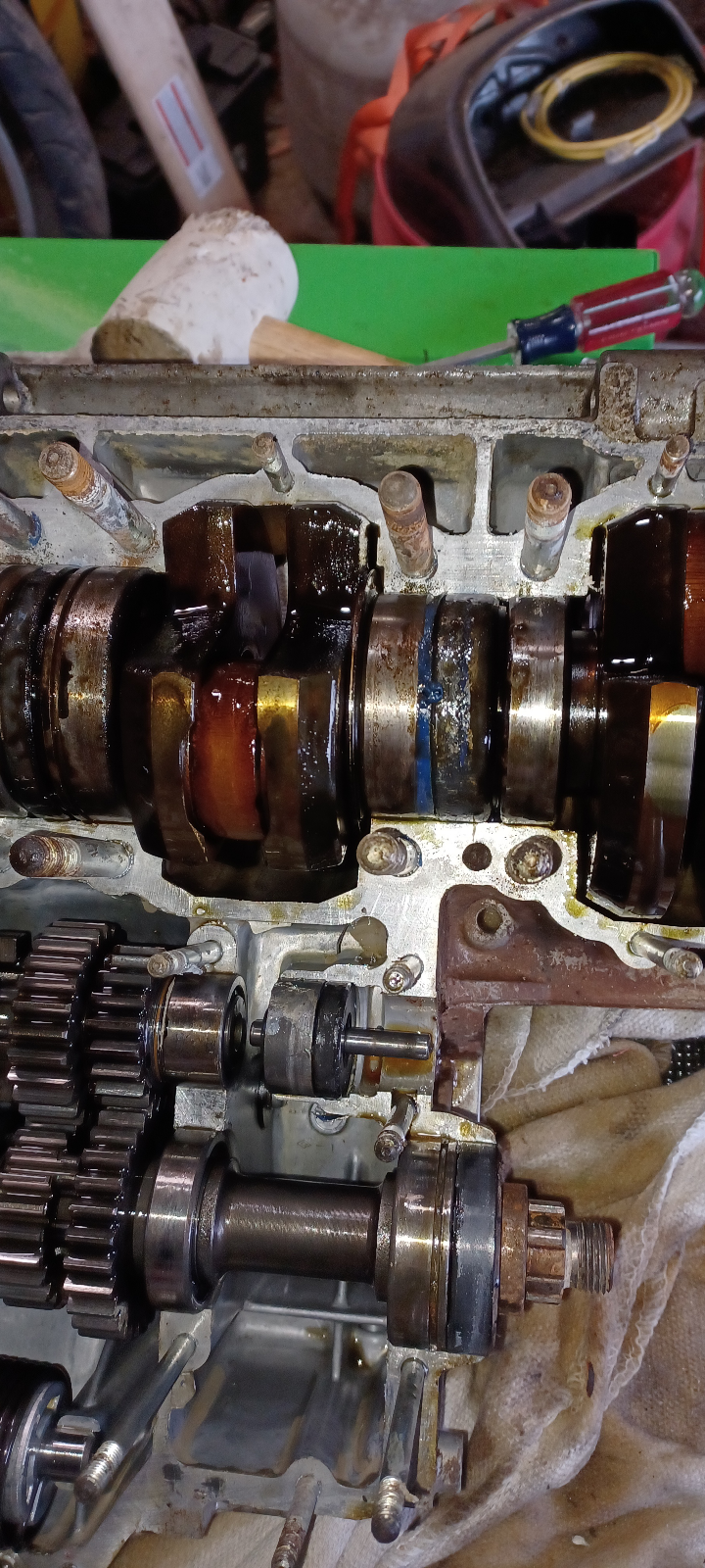

I'm building a motor for a guy who lives outside of Philadelphia. He bought the bike several years ago and the seller said it had been sitting, but should run. Gerald decided to strip it down for a repaint and wanted me to go through the engine before he reinstalled it. He hasn't fired it up since he bought it. Good thing.

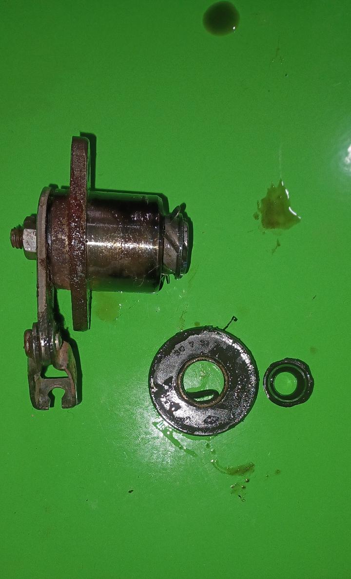

Previous owner installed a ball bearing pusher. That worked once.
Also, the previous owner tried to fix bad crank seals...

There is no issue using the releases that Jess or Ralf sells with the old style seal. I've used both and the seal clearance is just fine. The issue is the ball bearing pusher is longer than the original 4 or 6 spline release and also longer than the Sytech and Ralf's releases so you need to space the pusher out or use the correct seal.
