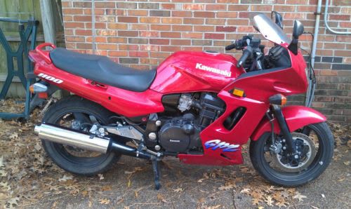

After a year and a half without a bike with valves and cams, I am adding another bike to the stable, hopefully this Friday.
1995 GPz1100, 8K miles and buying from the original owner
I will need to go through the carbs as it has been setting for a couple years. I am looking forward to getting this home and having fun.
PostPosted: Sat Jan 07, 2012 1:25 pm
Me likey! :thumbup:
