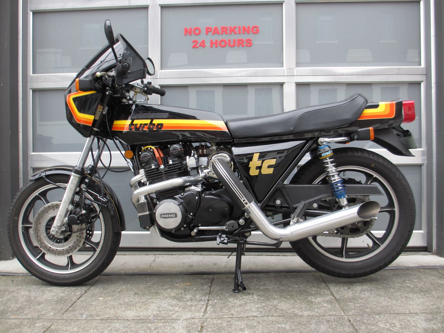

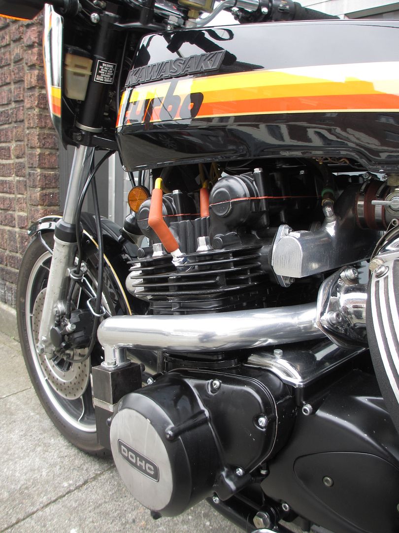

This is the Z1R-TC I had and sold to the previous owner of the H2. Dropped a valve in 1980 at 1300 miles and taken apart. Sat in boxes until 11/09 when I bought it. Completely redone with 1200cc low comp piston/bore kit and new everything.
Original paint with the exceptions of the sidecovers and front fender. Not done to 100% original but pretty darn nice all things considered. Scary to ride.

Oiler routed proper now. This 'site is already saving me big time :clap:

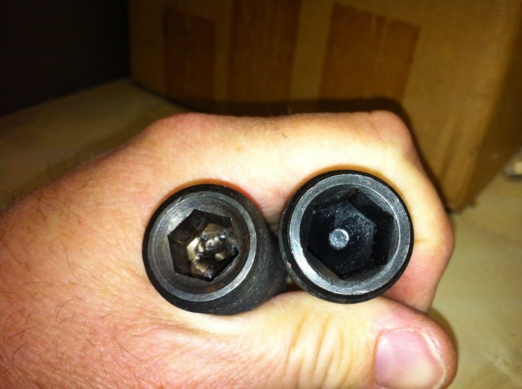

I don't have the luxury of having a bolt in front of me but that torx shape almost looks too perfect to be just displaced material IMO... Normally the head and hex of a socket head cap screw are cold headed, not broached.
I have seen broached hex's before but there is evidence of the broached material smashed in the bottom of the hex.

Andrew, I'm certain it's just displaced material, because it's a thin piece with air space behind it. Notice the points of the star align with where the least material was displaced to make the hex.

The end of the hex (after broaching) depends how the pre-hole is made, either drilled or machined

Of course you are right Jim if there is a cavity behind the "torx face" :) I should have known better... Lol
They must have broached that hex at allot higher temperature than what I'm used to seeing...
Here's an example I found to compare the cold broached as opposed to cold headed...
