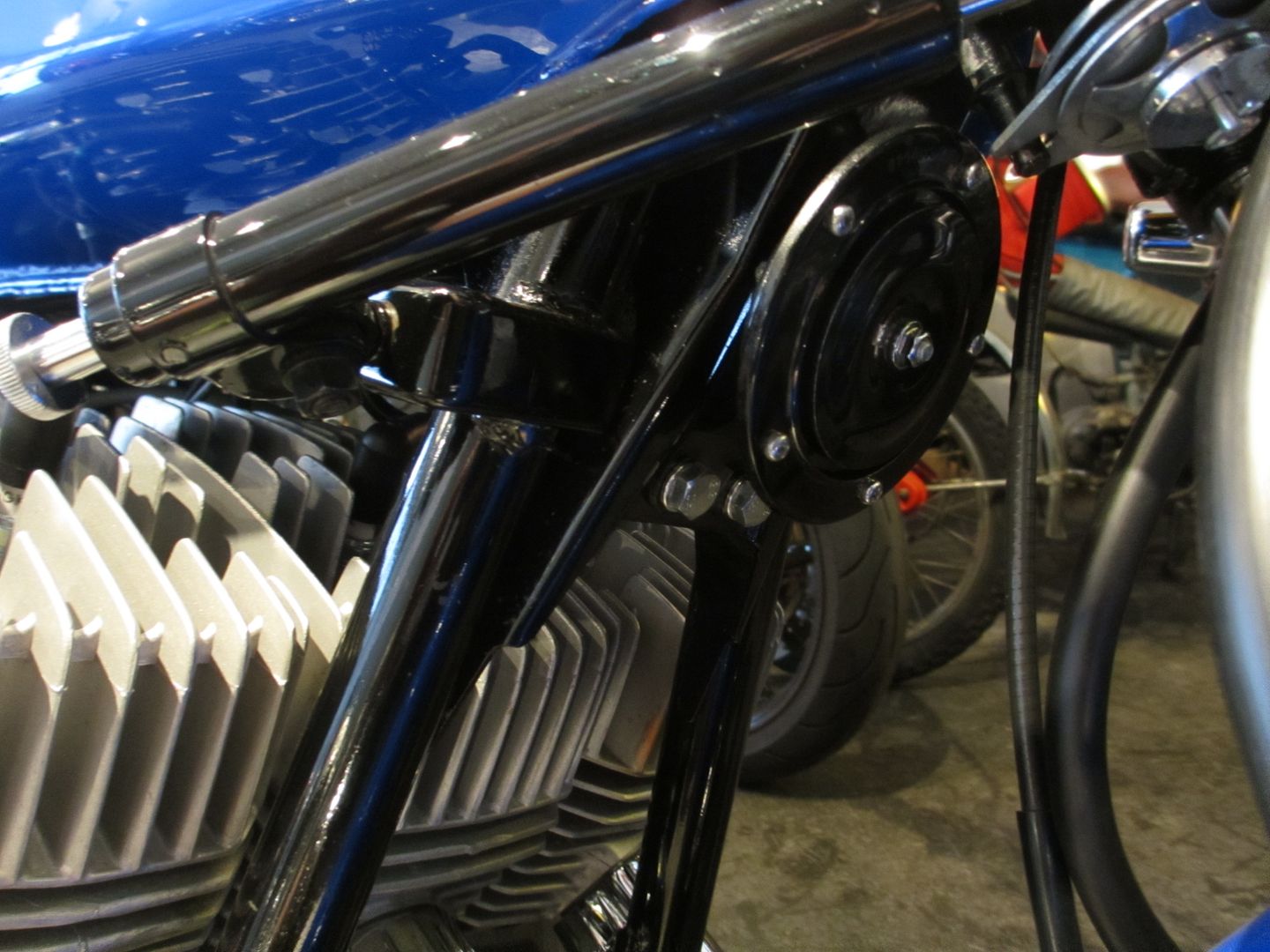

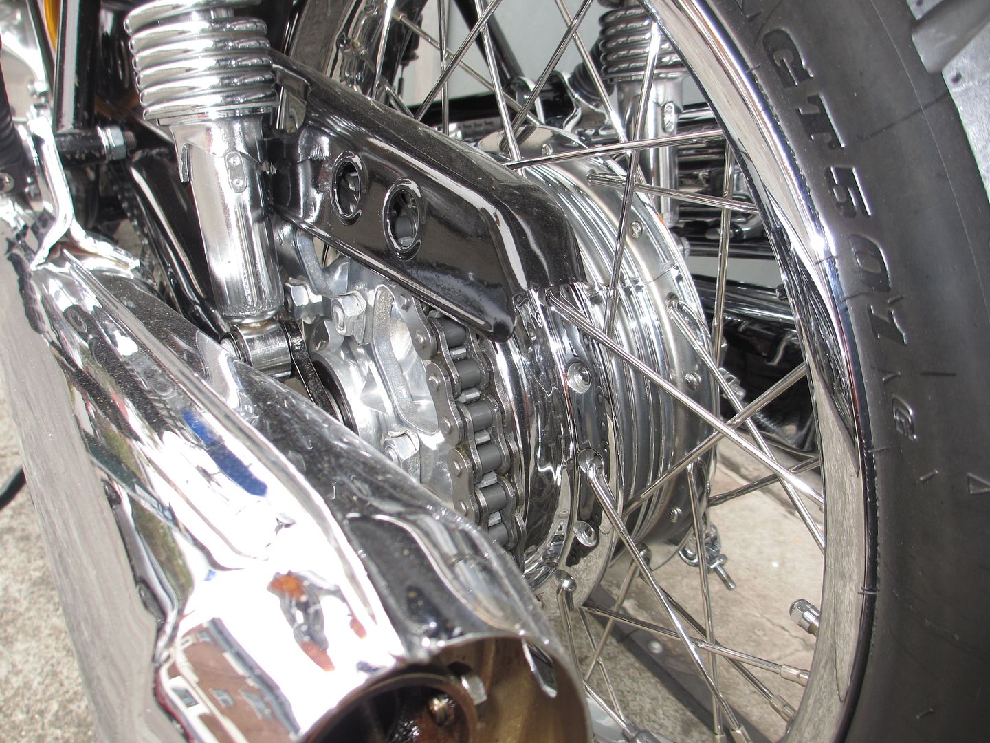

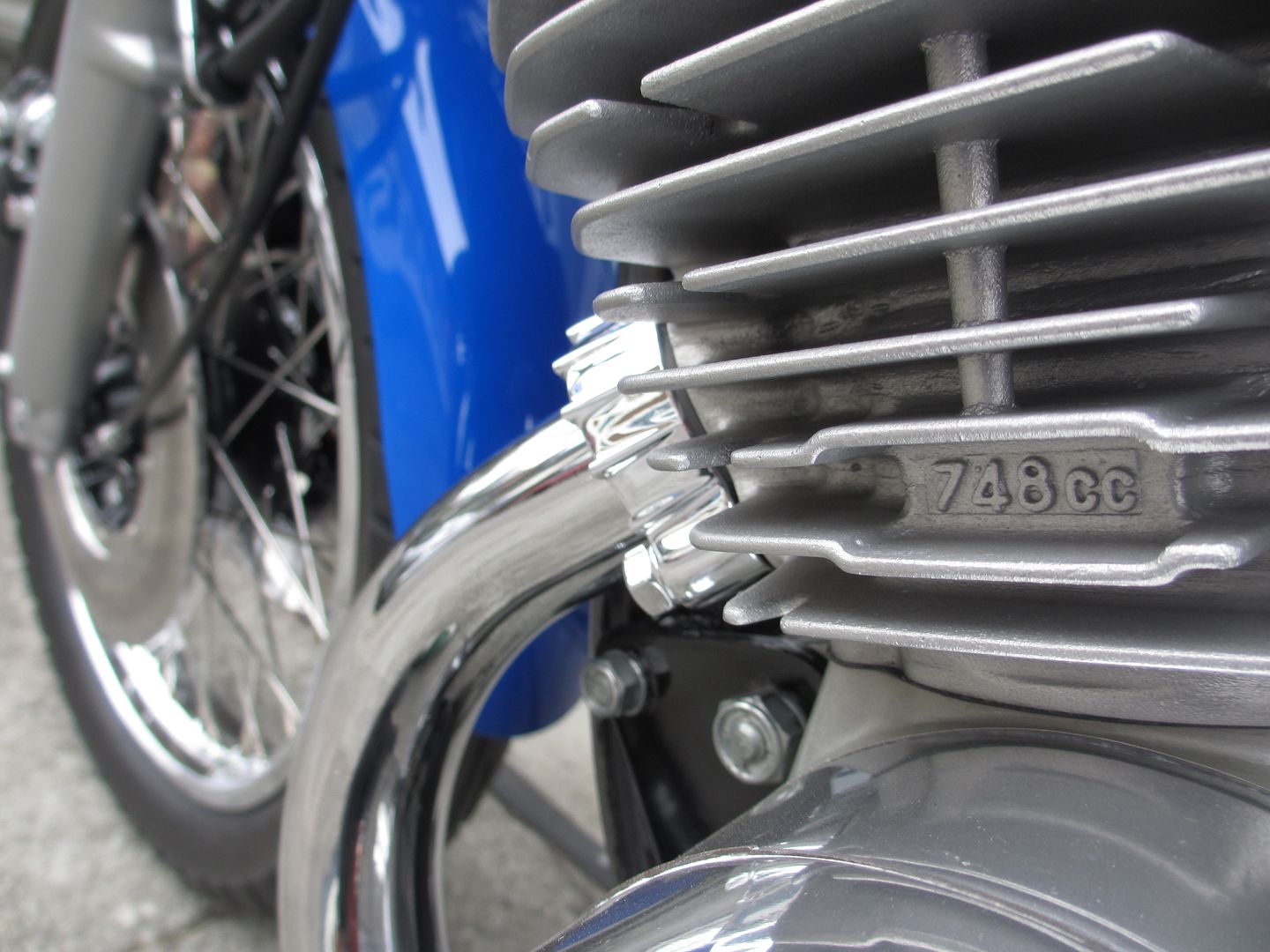

I've never had a chain oiler fitted, however I'd be checking the routing and fitting of yours - looks wrong.
If you have not twigged yet the horn is mounted upside down, one hard landing and it'll bend the bracket and damage the fender.....

Horn fitted proper now, thanks Nigel. I'll check the routing on the chain oiler. If someone has a pic of how it is supposed to be that would be swell.
Mraxl has lots of info at http://www.kawtriple.com/mraxl/ including period reviews with photo's.

Upside down "horn". I get it. Finally. duh.

The chain oiler is on the correct lug, but the mechanism should be inside the frame (open ends of the mounting clamp face outward). the hose runs by the frame down tube, but goes behind the chain guard and into the hole in the sprocket cover.
