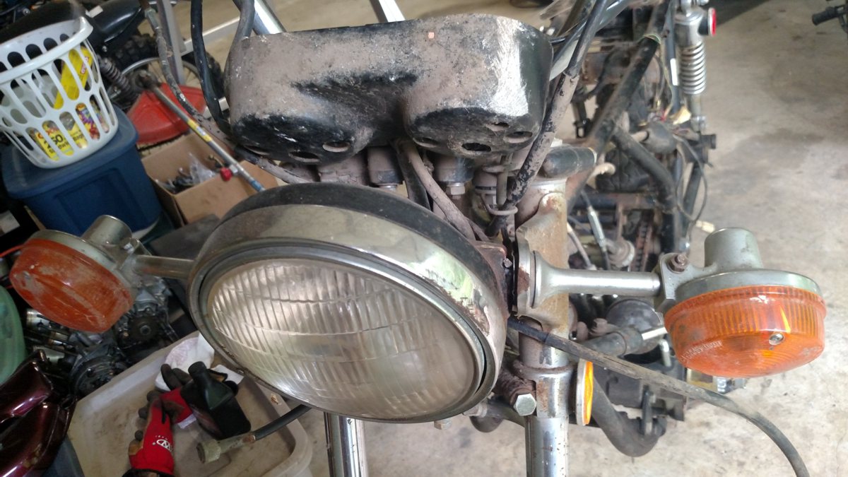

I'm not buying the mileage :think: stuff is too dirty for those miles . . . and a change of front wheel so soon ? I can't work out what it is, the wheel should be a KZ900 One or KZ650 Etc - Whats the date code on the rim ? Whats the date code on the disc ? Obviously the axle is also wrong, but the forks seem to be correct but the fork boots just don't look right. The front sprocket looks like the lock tab has been opened ? the rear sprocket tabs look suspect as well . . but the photos aren't clear enough :cry: It looks to be a later H2c anyway . . . can we get a photo of the meters :think:
RB - I'm glad you're chiming in. Being around many triples myself (not as much as you though), I believe it is all stock. The bike is dirty from being neglected and left outside. Let's put this H2C on trial to find out if it is 790 miles or 7900 miles. I will try to dig in more info.

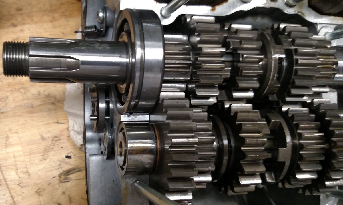

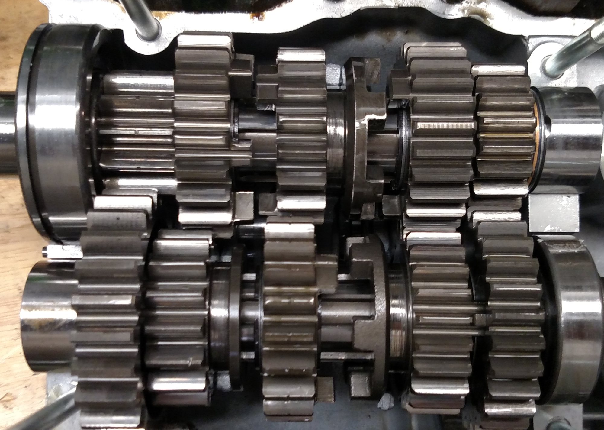

Signs of a well used transmission, rounded dogs. Low rust on the bike, but filthy. If a low mile bike stored outside, it would be the opposite. Really does not matter about the millage, your restoring it.

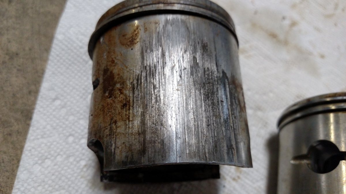

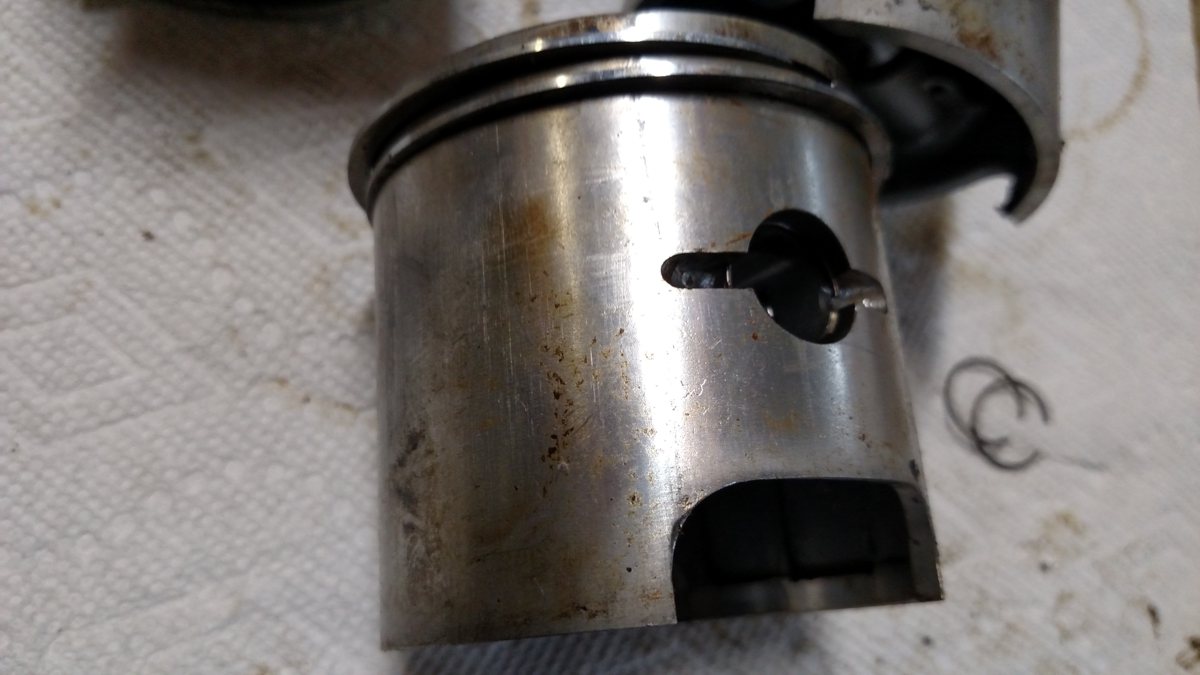

2. Motor was not stuck but center cylinder seized (see pic below) so bike was not running.
The other pistons look very clean.

4. Gears and dogs wear marks are consistent with low mileage motor
