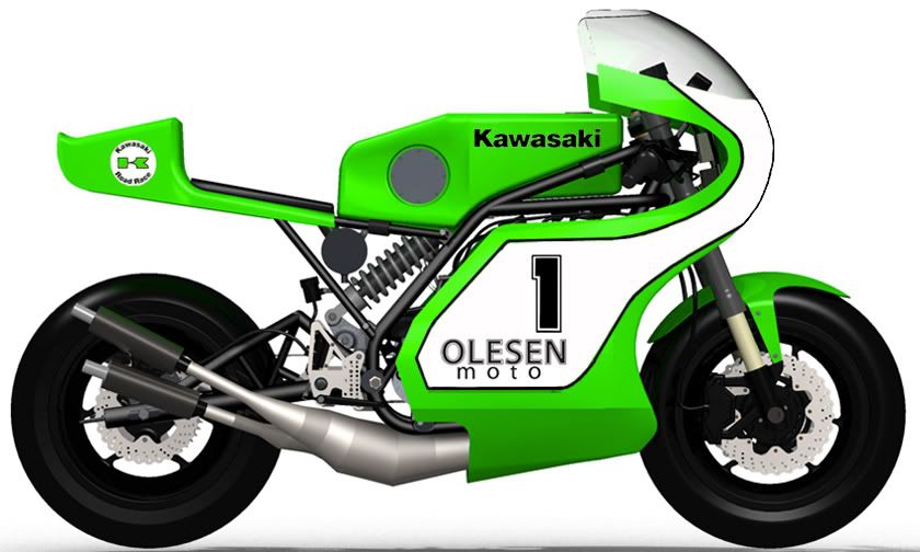

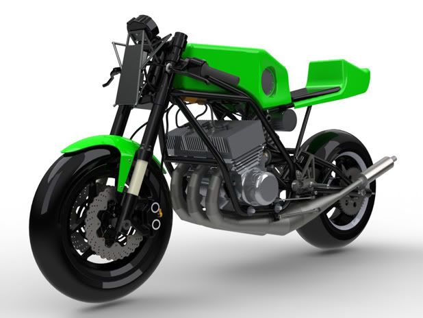

During my first year of university last year I decided I wanted to design a bike and attempt to build it over the summer so in my spare time I did a lot of reading on the subject, CAD work, and brainstorming. I've always liked the KR750s and wish I could have one so I decided to design my first bike to resemble the KR. I started ordering parts before I came home for xmas and when I got home I modeled all the parts I'd bought in my CAD program. I have a spare H2 that is in parts so I was able to model the engine components from that as well. What I ended up with was this.
I've got all the jigs designed for it and know exactly how to go about making it however the molds for the tank, fairing, and tail would have cost a lot to make so I decided to put this build on hold until I've graduated and have more money. I originally intended to race the bike as well but the class structure was not all that favorable for the old H2 engine. That got me thinking and I looked into the class structures closely to see where I could get the biggest advantage. I race in the CRA (Central Roadrace Association) and the ultralight class seemed like a good choice as it was open to unlimited singles no matter two or four-stroke. In the GP class I would be facing supermoto type bikes and Ducati Monster 620s for the most part. I could also bump up and run in the lightweight class (SV650s, Ninja 650s) and maybe even middleweight (600c I4s) if I'm lucky.

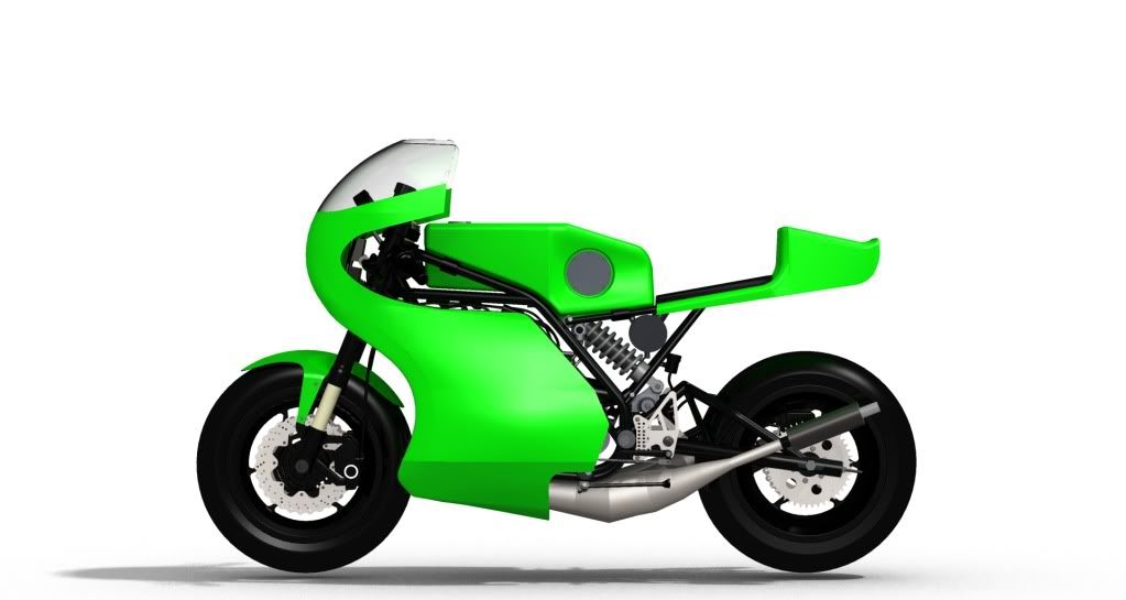

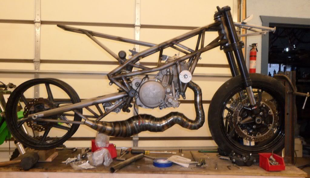

So I started the design process again! This time I made sure every component I designed I could make for myself. I chose to use a KX500 dirt bike engine as I have ridden the dirt bike and was quite impressed with the power they produce. With the modifications I intended to make to the engine I was expecting around 80-100hp in a bike that will weigh around 200lbs. I've had the engine running however I haven't tuned it or dynoed it yet so the power output is still a secret. Fortunately, where I'll be working over the summer there are an abundance of dynos so I should be able to get it tuned pretty well.
I've done an entire build thread at kxriders.com if anyone is interested in the whole process however you'll probably have to sign up as it is in a members only topic.

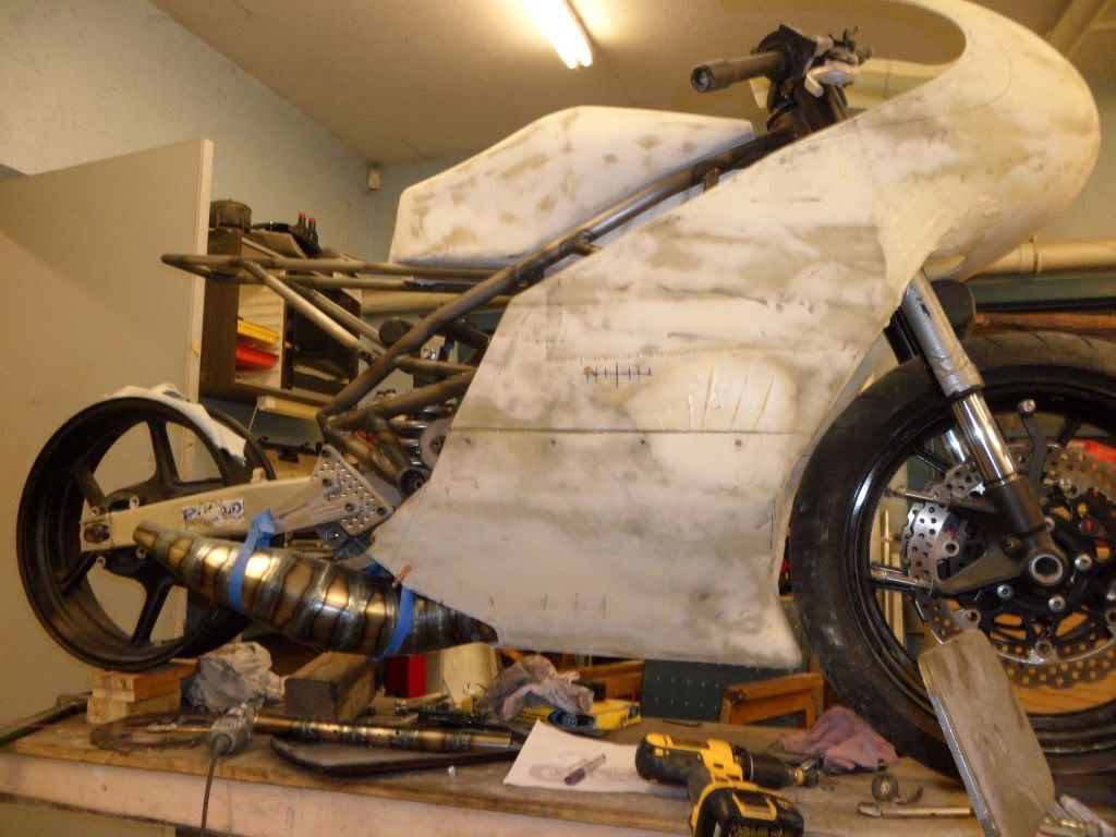

Here is where I'm at now. As you can see my pipe welding skills are not quite as good as Jim's yet, however I think Jim and I have figured out the problem (mostly cone fitment, some small changes to welder settings) so hopefully the next one will be a bit better. I think I've got about 2-3 weeks left of work on it before it's finished and ready for racing.

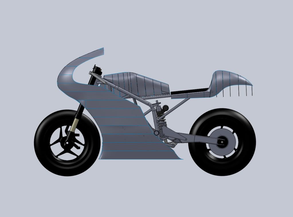

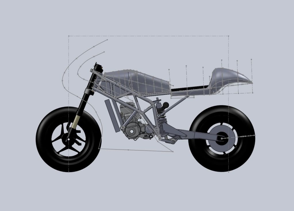

As you can tell a lot of changes have been made from the first CAD rendering to what's near enough the final bike. I originally never intended to make my own fairings or swingarm. Things just sort of turned out that way so I did quite a bit of hasty CAD work over the summer to incorporate those new components.

Thanks for posting the photos and description, Paul. I know I won't be the only one following your progress.
Why is the expansion chamber so convoluted?

Your welcome. Curving the pipe back and fourth came down to a packaging issue. I made one before that was pretty much straight and the widest part of the pipe stuck out to the side too much for my liking (see below). In the CAD model it looked like it had plenty of lean angle and in real life I wasn't sure so I decided to redesign it and try to fit the majority of the pipe right under the center of the frame. I'm a lot happier with the new one and the foot peg will scrape before the pipe. I think I can lean the bike over 55-60 degrees before I have any issues now.
