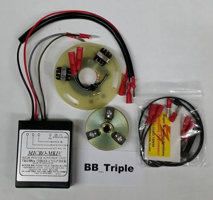

1980 & 1981 KH250 came with stock CDI, in Europe, and Front disc brake
Here is a pic of my CDI
https://www.dropbox.com/s/rm8qmwxr1mr0t ... I.jpg?dl=0

It's not stock... it's a Boyer-Bransden aftermarket kit. It may work OK, but they fire all three plugs at the same time (wasted spark) and are known for fairly high battery drain.

https://www.baxtercycle.com/wp-content/ ... 00x657.jpg
http://boyerbransden.com/micromarkiii.html

Wondering what a stock unit was then.
[url]
https://www.motorcyclespecifications.co ... 0-1980-81/[/url]
https://www.moto-data.net/kawasaki/kh-250-1980-1981.
As these specs call out for CDI on those years.
I would have assumed they just used the ones from the 400's
Thanks for replies

Internet listings are not always correct. In the 13 years I manufactured CDI units for triples, I never once had anyone ask for a KH250 CDI unit. This leads me to agree with:
mraxl wrote:
No 250 had cdi.
