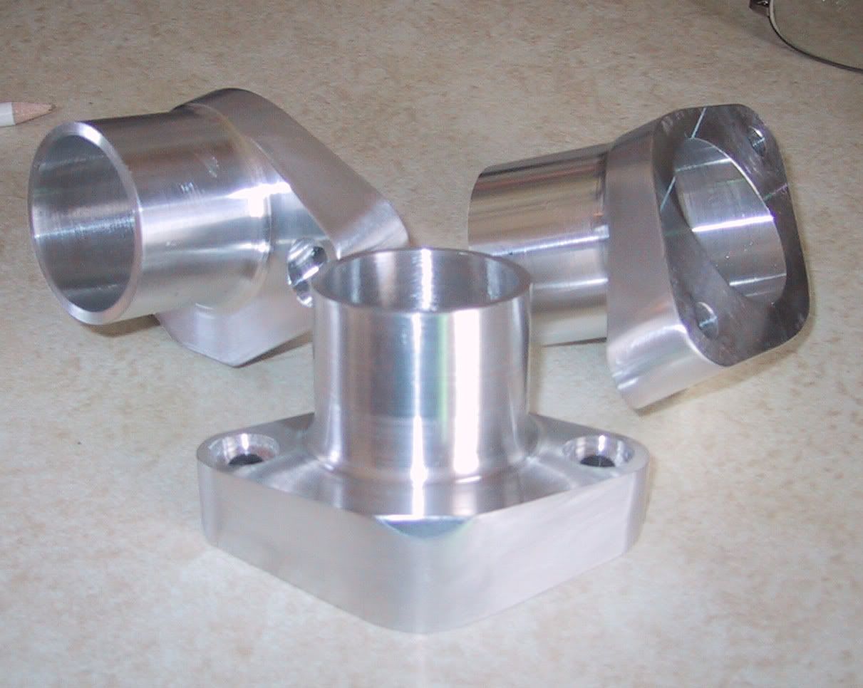

i used the viton o-rings and some copperseal and so far no leaks yet still early days.

very nice young albert, will you be getting them anadised to get a hard skin on them
 Post subject: Re: spigots i made
PostPosted: Wed Dec 05, 2012 10:14 pm
i was warned off of anodising them ,
the guy told me his tale of woe but i dont think i am getting the hole/true story,
as he said he had ali exhaust for a dirt bike and after anodising it melted at a tight bend.
i dont think that anodising would affect its melting point .
but i didnt want to find out the hard way.
any info is appreciated.
T I A mark

Very nice spigots Mark!!
There is no truth to anodizing changing the melting point of the aluminum.
Really all anodizing is, is a hard layer of corrosion, the material underneath is unchanged.

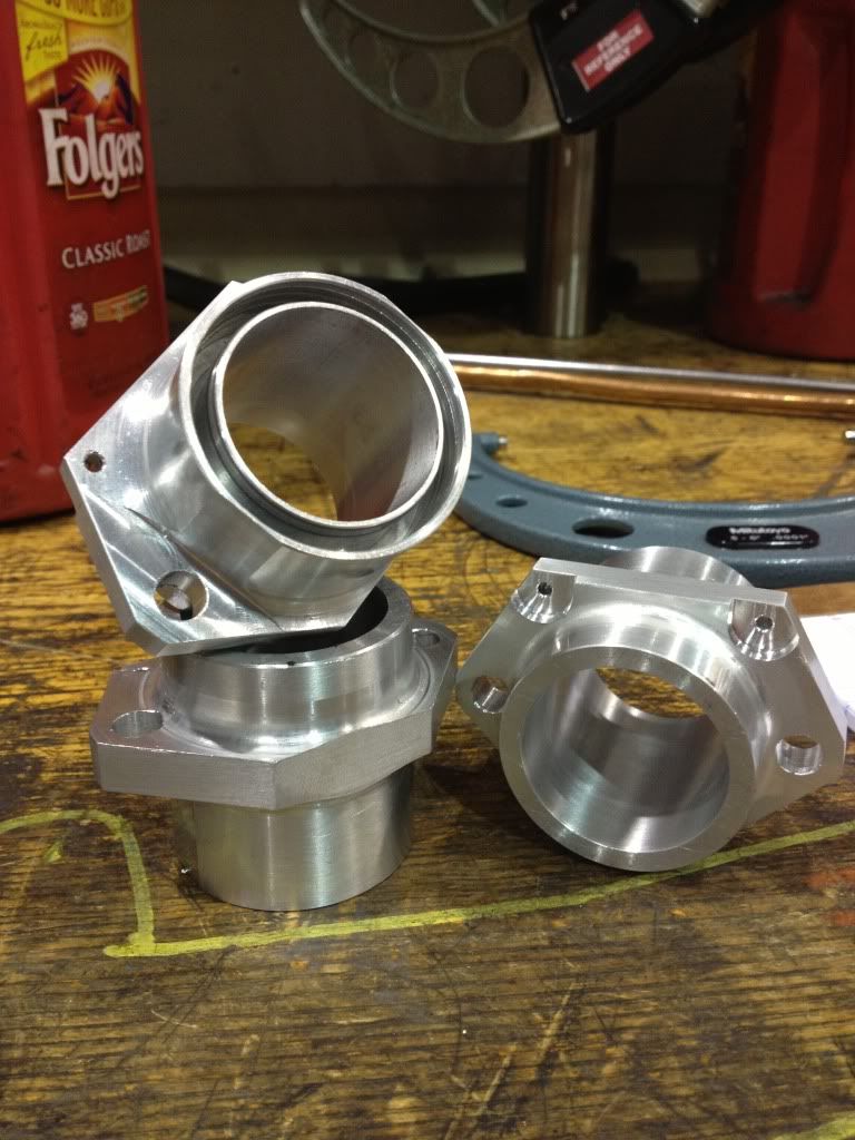

yours on the front and mine on the back
PostPosted: Thu Dec 06, 2012 7:37 pm
[quote="magee"]yours on the front and mine on the back
there neat, you got to love making bike parts out of ali. :thumbup:
i need the guys at work to slip up a bit more often with the titainium so i can snag the scrap parts and convert them to more bike parts .
