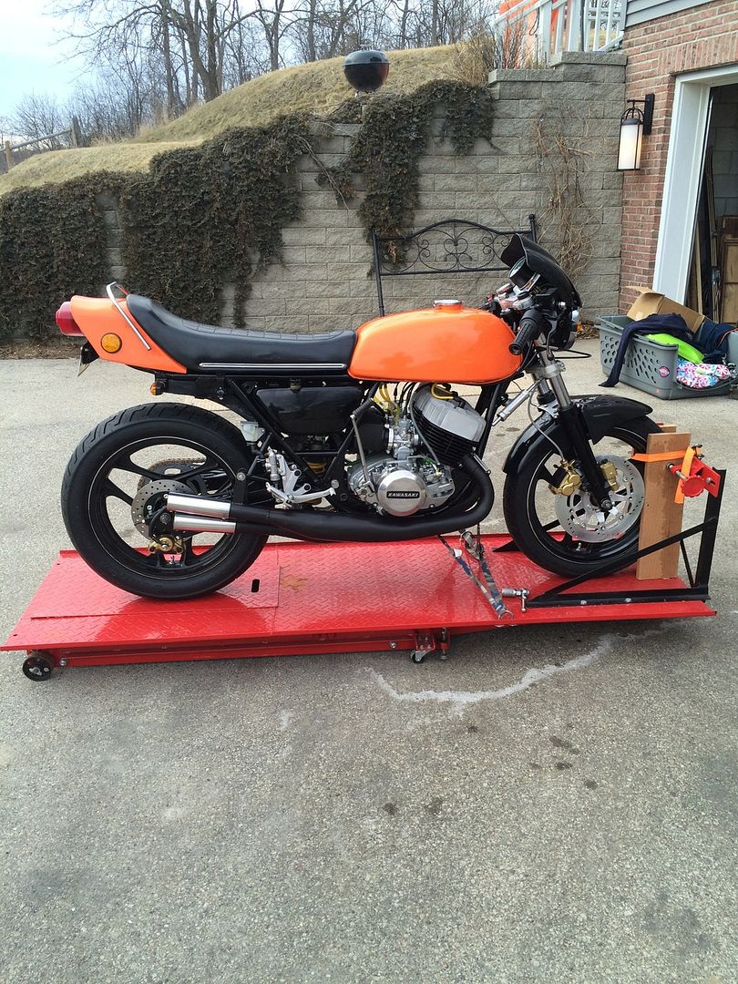

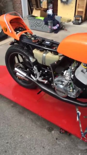

STARTED ON THE THIRD KICK!! (once I had the plug wires hooked up correctly :oops: )
All I can say is WOW! :o This thing sounds awesome, although it may be a bit loud! All the neighbors came out! (it was 65 today so they would have used any excuse)
My 13 yr old son was helping me and when it fired we both jumped! Almost forgot to hold the oil pump open! I am getting very even smoking from all three exhausts.
I did take it for a spin down the street very slowly and ran it thru the gears, the all up shifting is going to throw me for a while.
Still needs allot of work, the foot controls SUCK so I need to figure out something better. The sprocket cover will need to be Moded to fit. And now I know why the exhaust leaking thread! I will be reading that a lot closer now, I think some O-rings may be the ticket.
But all in all I am VERY pleased .
Now the tuning can begin.
I played with the Zeel a bit and I think I will be very close to 26 or 27 degrees advanced, but again, it all needs much more thought and work put into it and the day is gone!
I would like to THANK everyone here :thumbup: :thumbup:
It would not have happened without the input from ALL the members here!
And a special thanks to Ja-Moo and Mraxl, the resources are amazing. You all allowed a guy like me to build this bike!
And I would like to remember and mention my cousin Jerry Czerwinski who started this project, gave me a good start on this bike.
Many many years ago he taught me to ride, taught me to wrench, was one of my closest friends, passed away too soon, I miss him!
I don't know if the video will work and sorry for the poor quality my phone is all I have, and excuse the bad back ground :lol: need a photographer!
ImageClick here for video ( I tried to edit it…oh well still not the best)

 Post subject: Re: Inherited H2 project
PostPosted: Sun Mar 15, 2015 7:56 pm
YEA! :clap: :clap: :clap:
looking great, I like the orange!

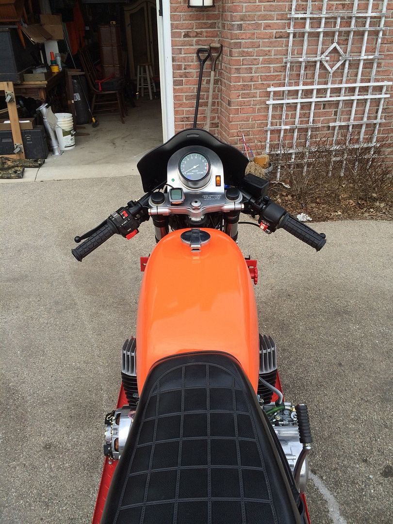

PostPosted: Sun Mar 15, 2015 8:04 pm
Posts: 564
Really nice job !!!!
The photo of the cockpit view is really cool ... :D
Nice nice and nice
PostPosted: Mon Mar 16, 2015 5:52 am
Posts: 971
Location: Eagle Wisconsin
Thanks!
I like the way it looks, I have some '72 graphics on the way in black and gold, I hope they look as good on the bike as in my head.
There is no key so I wired the run/off switch and ran a LED on the dash so I know when the power is on or off, just so I don't have the power on when its sitting around, although I don't think leaving it on would hurt anything either. The lights are wired separately to the orange rocker switch, and the tach I bought for $20 it was NOS, for a kz 400 I think. I wired the shift light to the stop lamp on the tach. The tach and the Zeel controller match RPM so the tach works great.
PostPosted: Mon Mar 16, 2015 7:56 am
Excellent work!
PostPosted: Mon Mar 16, 2015 8:43 am
Yeah, very nice, the sit of that thing just looks RIGHT!! :thumbup:
