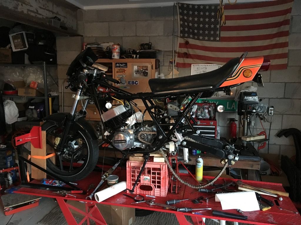

I posted this in general chat but here is how it sits now, actually before, its apart again now :thumbup:

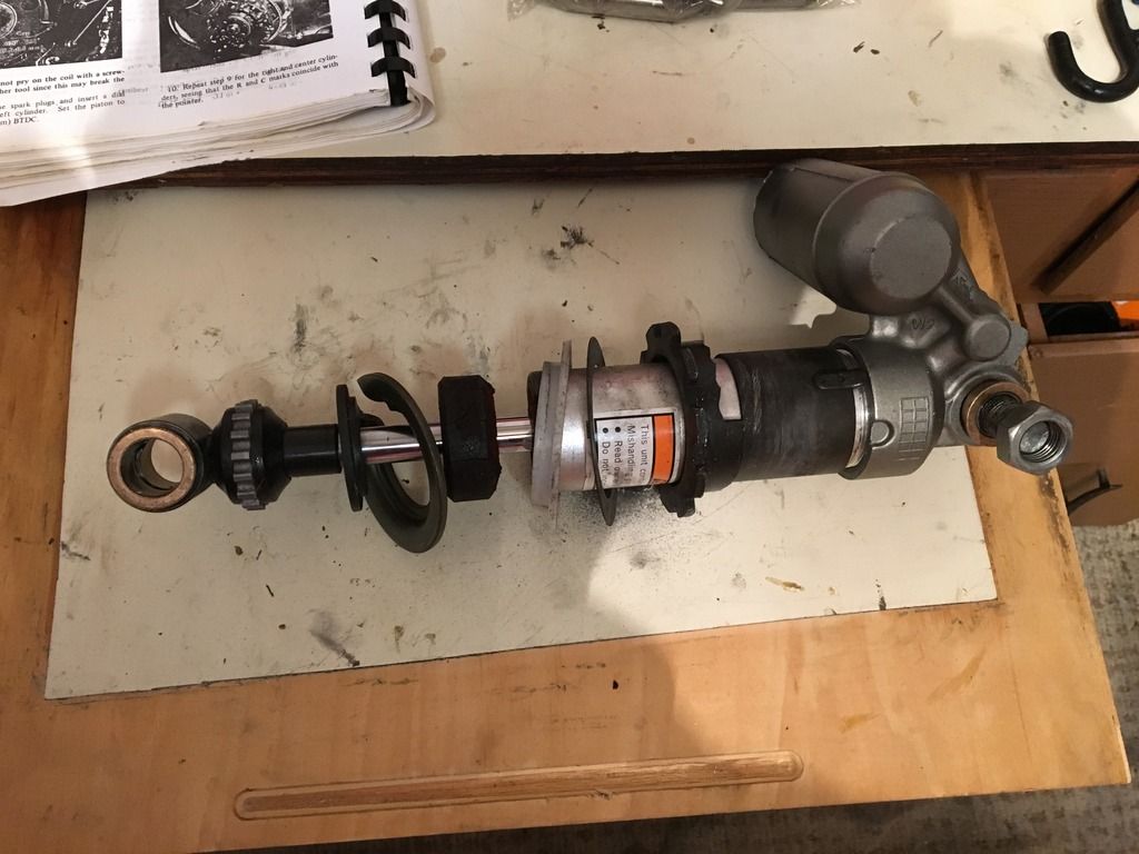

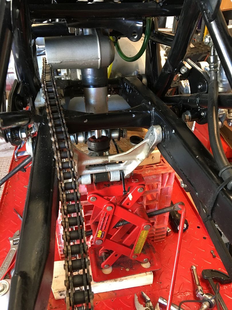

Been doing some more work on the project. I am trying to get the rear shock straightened out with spring rate and possibly dampening.
I have removed the spring from the shock and remounted and measured the swing arm travel vrs the shock travel. And I contacted a suspension guy and hope to get some answers soon.
The Shock travels is linear, for every 10mm of swing arm travel the shock travel is just under 3mm. I hope I can just get a stiffer spring and be done with it , but somehow I doubt it.

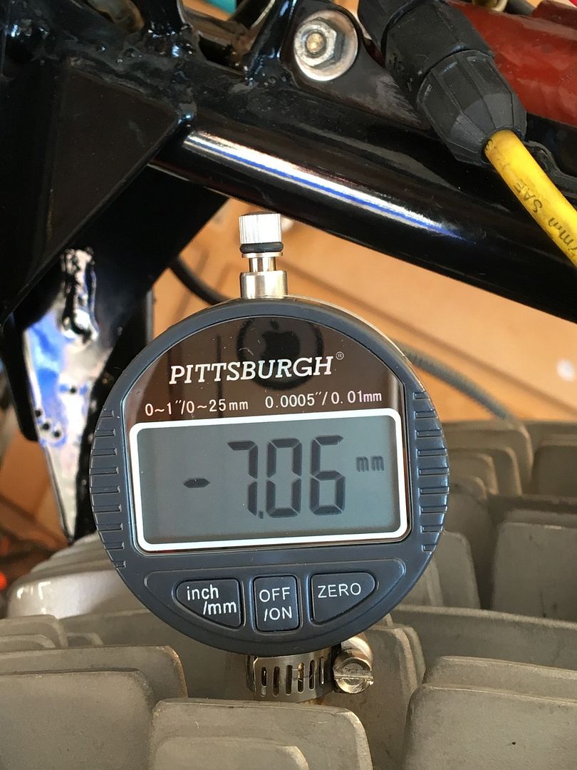

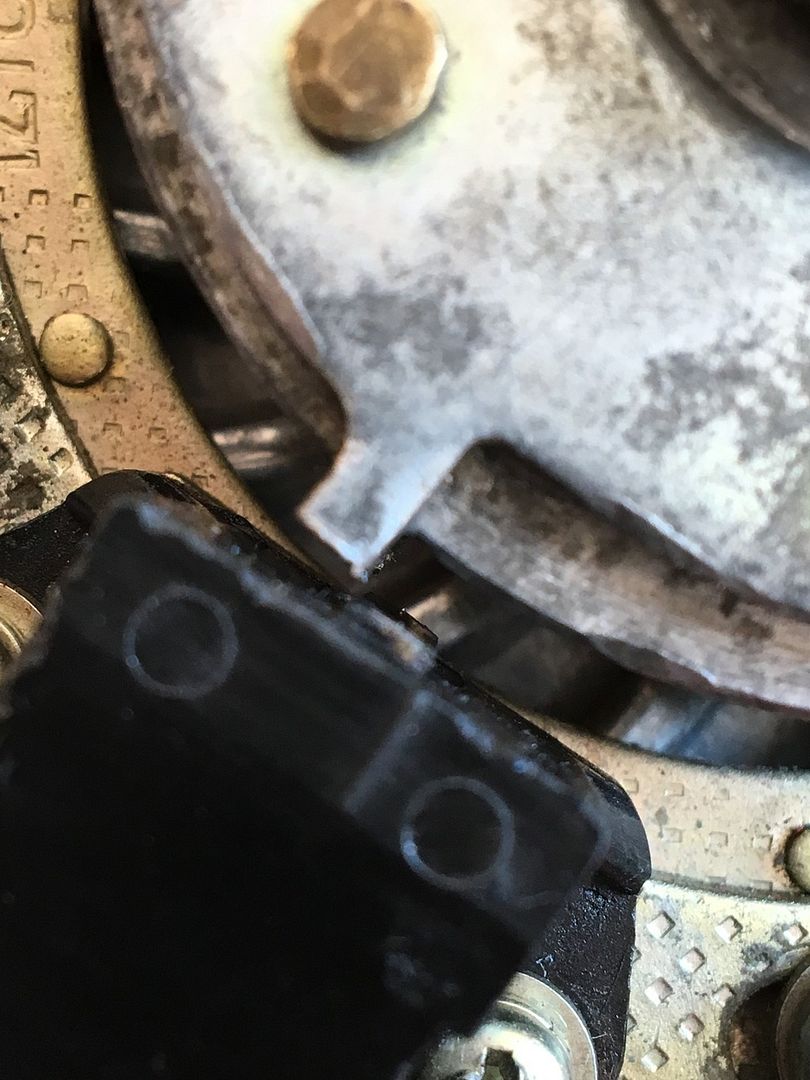

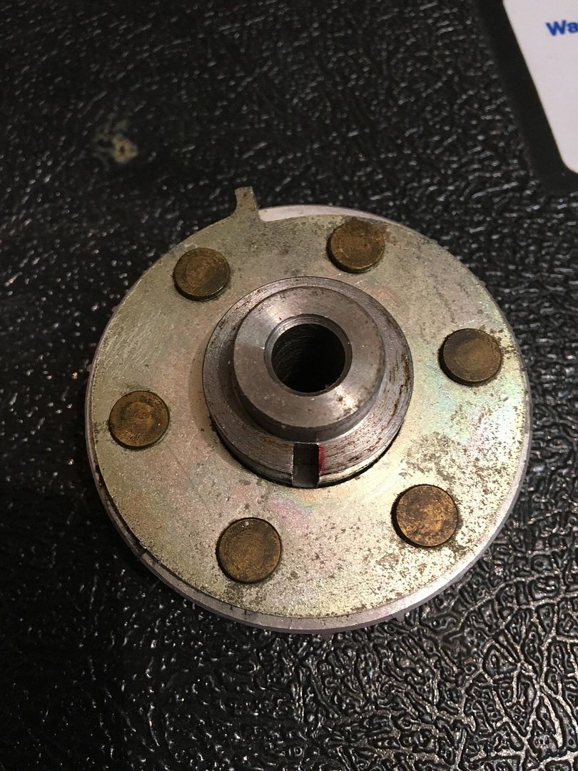

I am attempting to try to get more advance out of my Zeeltronic ignition.
What I found was even with the plates and pick ups advanced all the way on my engine, using the edge of the ignition rotor pick up as per Zeel instructions I could only get it set statically (not running) to 23.3 deg., piston drop of 3.22mm. After reading some stuff Jim H posted that the Zeel has some trouble with the stock Kawasaki pickups because they are so small and that there seemed to be a wide variance between the results I am getting compared to others. I acquired a second ignition rotor and modded it to get static timing to 35 deg, about 7.06mm piston drop. I should now be able to get stable operation with timing advance past 23 or 24 deg. I am hoping as suggested that advancing the timing will help the flat spot I am trying to resolve. When I tried to advance it before the Zeel would get weird and I believe it was because it was programed to close to the static angle. Once I backed off the max advance to less than 24 deg it would stop cutting out.
It was an easy Mod, but it is not tested yet. If it doesn't work I will simply go back to the other ignition rotor.

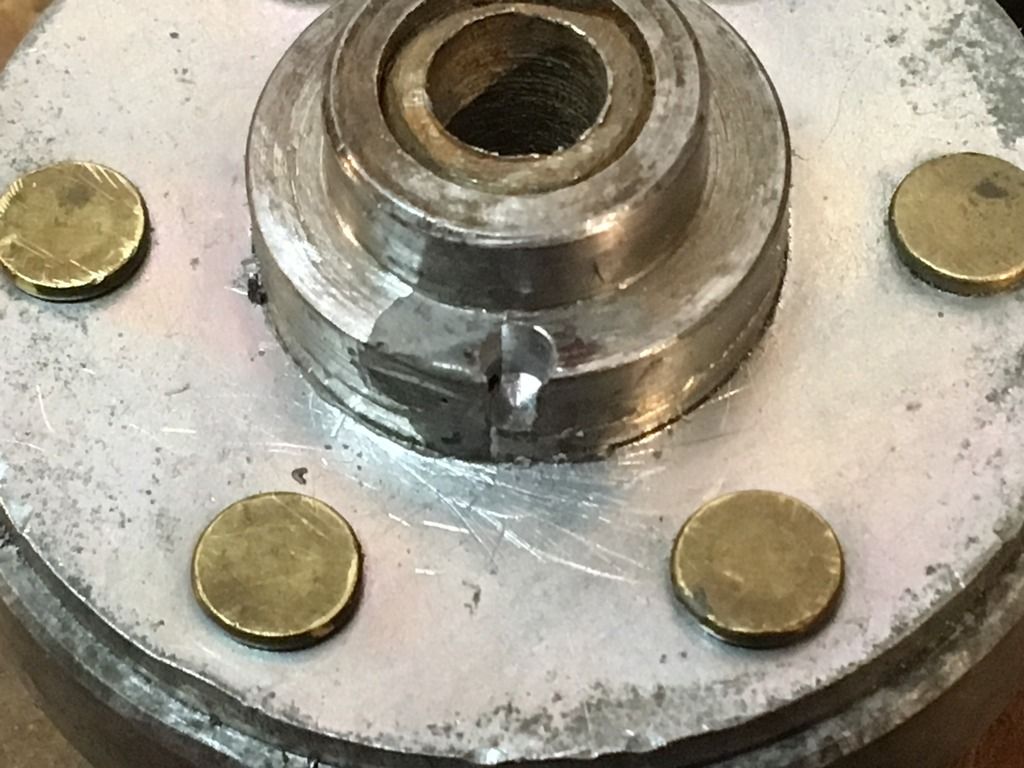

You can see I filled the original slot with epoxy and drilled a new index.
I was/am worried that the index slot may move in operation but i think there is enough of a lip of metal left and I used a dab of red loctight on the interference fit that goes into the rotor. By moving the index less than 1/8" and having the plates and pick ups advanced I actually had to back off the stock pick ups just a hair to get everything to align at 35 deg.

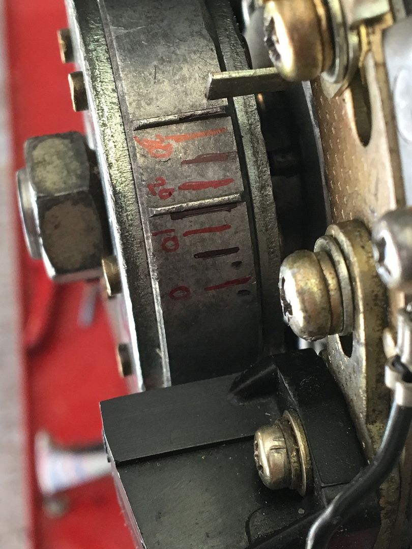

It of course changes all the stock marks so I remarked the rotor from 0 to 35 deg in 5 deg increments.
Once I get it running I will post results.

Joe, could you put up a pic of the Zeel system you have. The modded rotor looks like a stock one to me.
John it is a stock Ignition rotor with the indexing "groove" filled in and then re-drilled to provide more advance.
The Zeel is a PCDI-30.
As Jim H posted elsewhere his experience is the Zeel fires when the ignition rotor and pick-up are nearly aligned when using the stock Kawasaki pick-ups. Not before as with the stock CDI.
This is where the Zeel instructions say to measure the static angle while the engine is not running.
This is the one ignition rotor I have. The indexing groove on the back won't allow me to get the static measurement beyond 23.3 deg. The red mark is where I needed to drill in order to advance it.
This is the other Ignition rotor I filled and drilled to allow the ignition rotor and pick-up static measurement to get to 35 deg.
I can now adjust the pick-ups if I need less or adjust the Zeel ignition.
The Zeel can work with up to 45 deg static angle setting and I can adjust the timing curve to any point below the static angle setting on the Zeel. So hopefully the static angle setting will be at or near 35 deg when I set it with the timing light and I will adjust it to 23, 24 , 25 or whatever max advance as needed for the timing curve, to help with the flat spot some.Image

You might have some trouble with that. Changing the rotor position like that throws off the magnet alignment with the stator. So you may not get a good spark.
 Post subject: Re: Inherited H2 project
PostPosted: Sun Dec 20, 2015 4:46 pm
I've seen People drill the stator, and shift the pin a little - might be an easier way...! :think:
