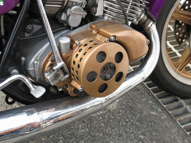

An H2 in Japan, I think....

The Japanese dry clutch photo shows the finned dipstick handle. That dissipates the heat from the clutch that's not cooled by oil. :lol:
