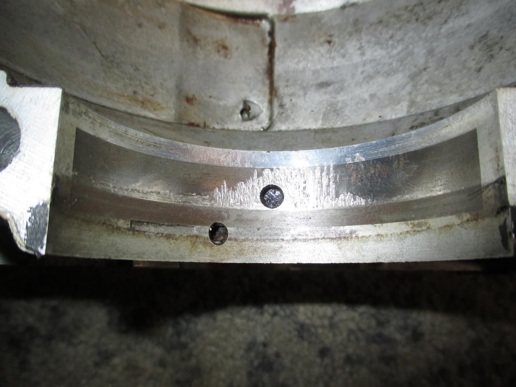

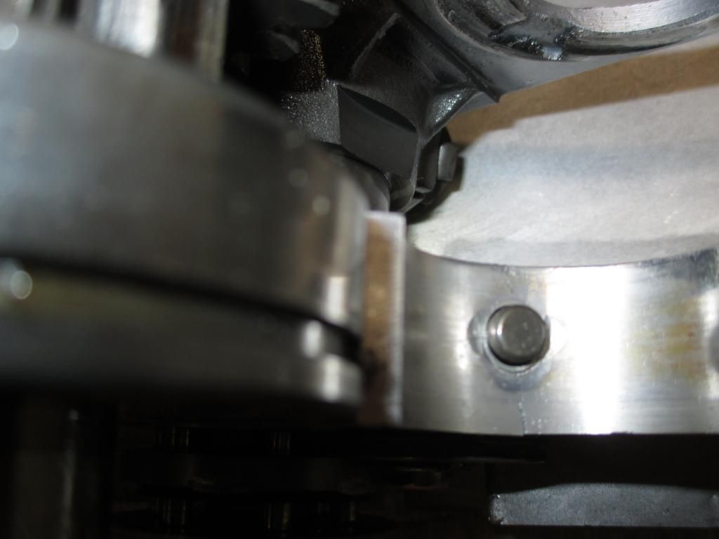

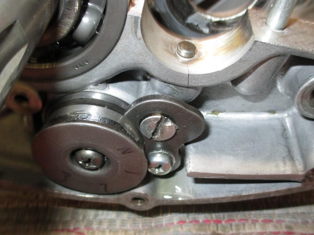

This does not look good at all :cry: ........I have just started having some transmission 1st gear issues........pulled the motor and opened it up.......figured bent shift fork and burned.......found several issues, crank bearings wasted and now a hairline crack with the small needle bearing goes on the output shaft boss (sprocket end) of the trans where the dowel pin sits, which is somewhat oblonged and a bit loose now :problem:
the crack as you can se comes in sideways and is also starting vertically at a 90 degree angle :shock:
I am sure this is a really stupid question, but I will ask anyways.......has anybody ever been able to heliarc this and remachine ?.......or basically start looking for a set of cases :?:

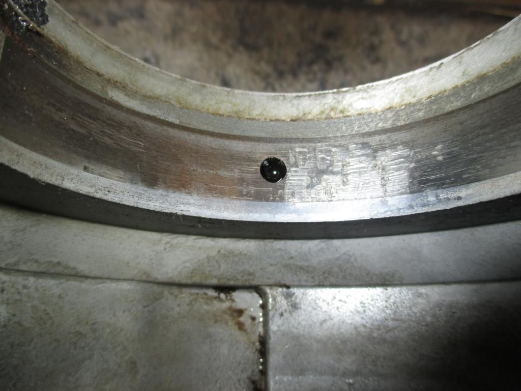

Also, a bit of galling on the left crank boss (maybe not bad), and on the right side (maybe not to bad either).....the bearings never spun
OR DOES ANYBODY HAVE A SET OF H2 CASES FOR SALE.....Please PM me if so.......there is two sets on EBAY, one has had the pins pushed in and the other looks really rough
Please advise and thank you guys very much......Phil Mosher

That sucks! :thumbdown: Pushed pins are not a big deal, if it is a good price. Not sure welding will work and not deform the cases.
PostPosted: Fri Jul 25, 2014 6:48 am
the worse on yours pictures is the bearing seat for crankcases, very bad, add the fact as if you weld around the gearbox pin failure you would deform the cases as wrote Mo :?
try to find some good cases would be a better solution.
PostPosted: Fri Jul 25, 2014 7:58 am
the crack can be fixed, but the cost to cost ratio of having a QUALIFIED welder/machinist fix it vs. just finding a new set of cases......
I'd find a new set of cases.

Thank You guys and that is what I figured........Somebody up in Kalamooza Michigan was drag racing this bike and it's not hard to tell, 4 of the 6 crank bearings are wasted, crack in the case, leaking seals, may need a few trans parts........holy crap !
I just spoke with Charlie and ready to send him the crank for all new parts and KOYO bearings and rods, spoke to Moo to get him the heads and Cyl's......was gonna send the cases to get blasted, now this :banghead
Scrambler 73, I will check on the Case number.....I beleive it is 38XXX......I don't really care about the serial number as somebody put a different engine in the bike anyways (the numbers are off by 2000) and I actually want to modify for a three line pump (drilled passages in the cases)......If you know of a set of cases any year (I think they will work ?) PLEASE LET ME KNOW, and I will make worth while......that would be a godsend my friend :!:
There is a set on EBAY that have the pins pushed in that does not look too bad at $395......do you drill above them and push them out ?.......the other set on ebay looks really nasty
