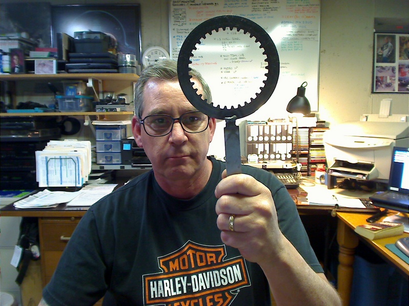

You don't need a special tool, you can make one out of an old steel like I did - but a great guy on the board (who shall be nameless)told me use a penny or other somewhat soft metal between the gears to lock them and you can spin off the hub nut (thanks John). :mrgreen:

Actually the penny trick is for removing the pinion nut off the crankshaft. He won't need to do that. The clutch tool is necessary to get the clutch nut off, that is if you don't have an air impact. I think Jessbikes sells a clutch holding tool which you will nedd to get it tight again, do not impact the nut back on.
