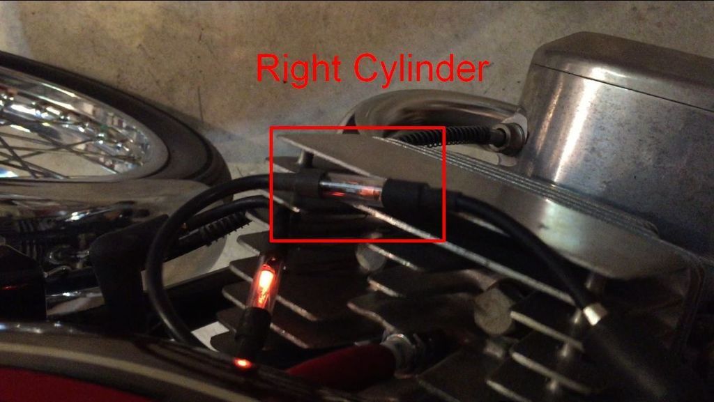

Still having problems with the low power/bog at mid throttle. After lots of carb work, plug readings and jetting (right cylinder always a little rich) I started looking elsewhere and decided to check spark once again. When I originally got the bike running I just checked for spark but didn't look too close other than to make sure it had spark. Bike runs good at high and low RPM just low on power/flat under a load. What I have found is weak spark on the right cylinder. The points were replaced but not the condensers I haven't started troubleshooting.
Are the coils the same so I can switch them to see if the problem follows the coil? (parts manual shows three separate part numbers)

I trimmed the ends of the original plug wires back a little bit and replaced the plug ends and caps with NOS ones I found at a dealer. This fixed the issue about 80% but I still have an intermittent miss on one of the cylinders. I haven't had time to chase it down any further other than the spark gets weak but doesn't totally stop. Let me know if you find anything on your end.
