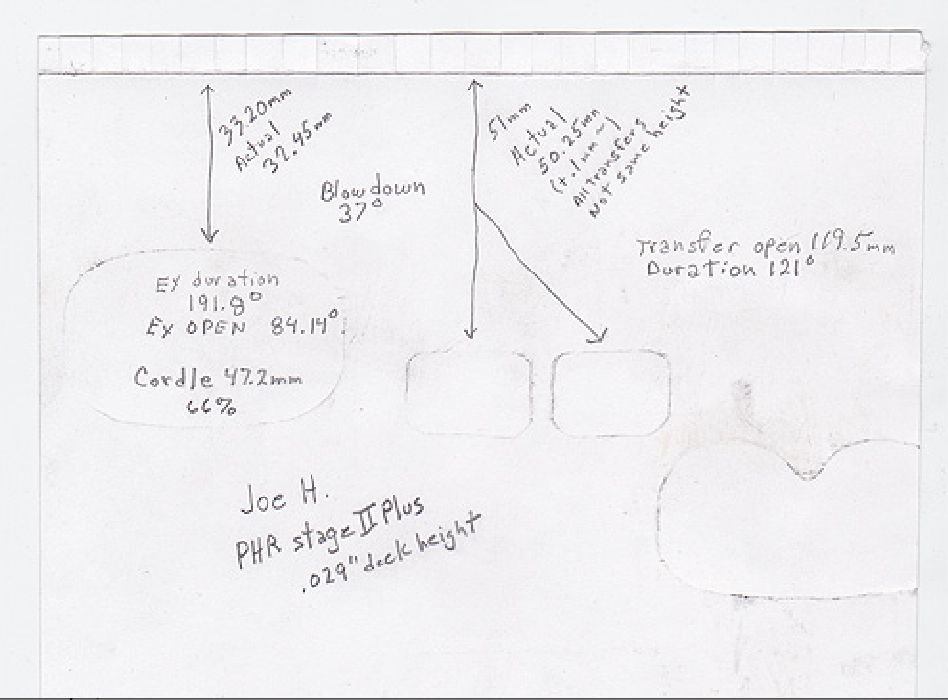

Just wanted to post some stuff.
Im not really sure what Im looking for except maybe some general info so I can put this all into perspective.
I dont know what to expect from these bikes and it has been a very interesting and somewhat frustrating learning curve.
I still don't have the jetting right but I think I am trying to achieve something that may not be achievable.
Below is a port map Moo did when he had my cylinders.
Any thoughts on how the power curve/ behavior would be with this porting would be appreciated.

Your port map points to a quite streetable H2 demus. This should work out quite fine, not radical at all, but remember your pipes are quite revvy I think, but I am not sure as I have not dynoed them.
But be aware of that 34 carbs on a ported H2 with pipes are VERY small. At least I had success adding 38's instead of those rather tiny 34's.
From your description, it seems like you have a huge flat spot right before you are in the powerband, since you need to be at 6500 to be able to accelerate. That is same behaviour as I had running 34's, Aylor reeds and pipes, and I could not get rid of it. (even tried the moderate higgspeed pipes, but the huge flat spot was still there, but I had great peak power, 109 rwhp with them jollyes, and 90 I think, with higgspeed)
I have the dyno curve somewhere of both vm34 reeds higgspeed and jollymoto comboes somewhere, but it is not really combarable to yours as the ex duration was 200 degrees, with ex port wider and more square for better blow down area and stronger exhaust pulse, and also the transfer duration was higher

From what I can tell with the way this was set up with the porting and the pistons which had 4mm cut (don't matter now with the reeds and the holes in the sides pistons :lol: ) and the Spec II pipes which were all part of the "package" PHR sold my cousin it was meant to be driven at a high rpm. And this would have suited my cousin well he liked riding every bike he had to its limit all the time, what ever that limit was he would be there. When we were kids riding I had to promise my mom I wound not try to keep up…I couldn't anyway but I tried :D . He even beat me in the twistys once on a Harley Soft Tail and I was on my Suzuki GS1150, both bikes are pigs... but a Soft Tail… :oops:
Anyway with the flat spot I assume changing needle heights and such would have little affect in that area, is that correct?
If I am trying to jet the flat spot (which I think I am) am I going to mess up the jetting somewhere else?
