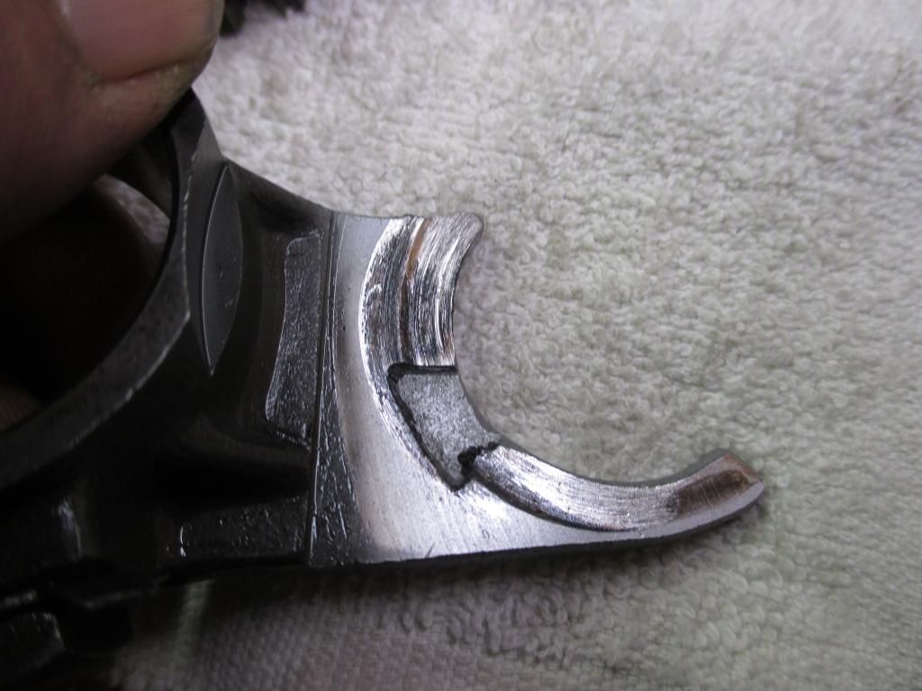

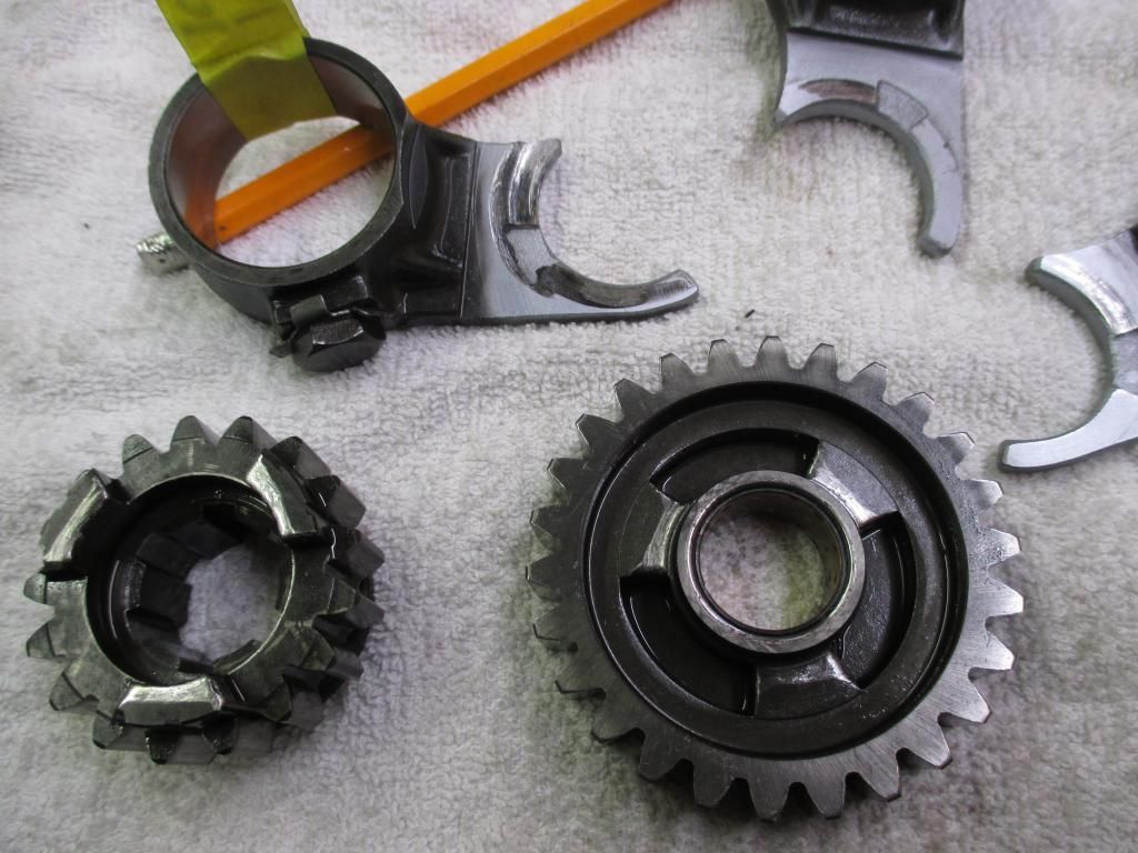

1st gear shift fork is deeply galled and wasted and looks very slightly bent, the others dont look good either (supposed to be having a set made HVCcycle thru Aussies)

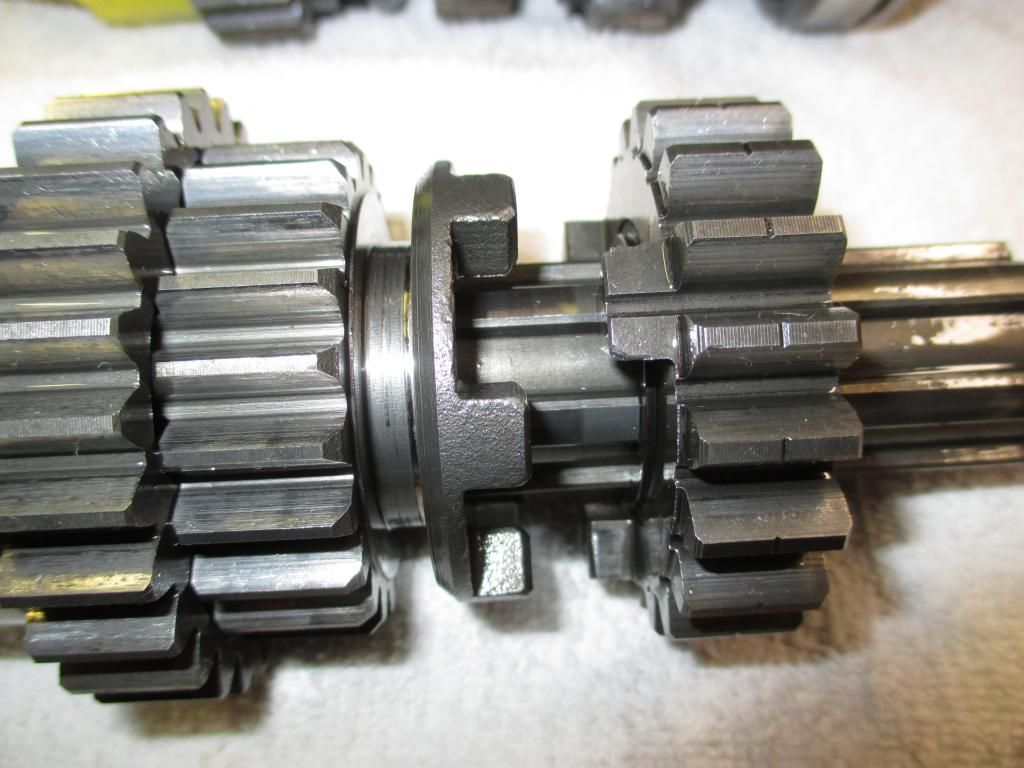

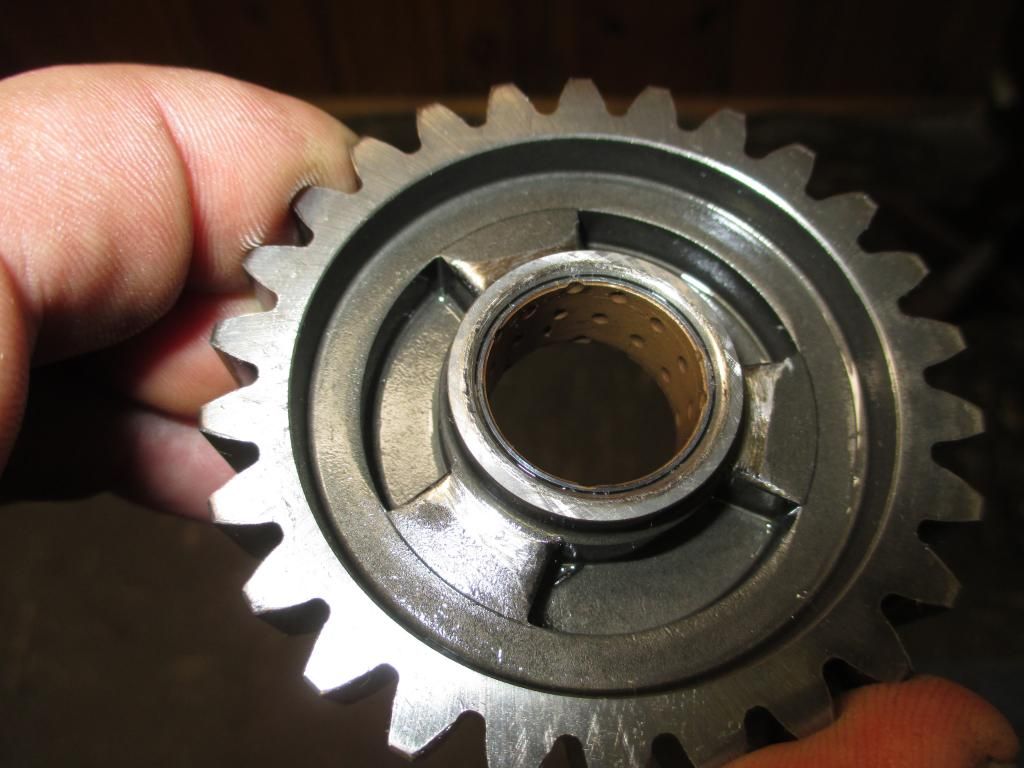

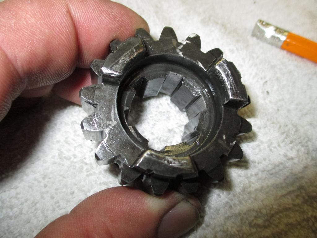

The 1st gear on the output shaft that has slots look bad as does the 4th gear the locks with it.........the 3rd gear dogs have some rounding as well :problem: ........looks like I will be chasing some gears as well

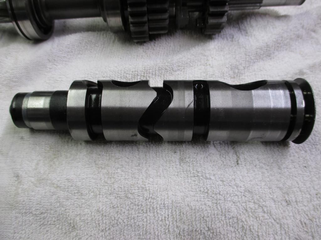

To me, the input shaft gears and shift drum don't look bad at all........we will see what Mark at R&D transmission says :?:

Upon futher reveiw it would be
1st output......PN41........13129-036........26 tooth
5th output......PN40........13137-019........17 tooth
and possibly destroyed
3rd output......PN39........13133-024........20 tooth
4th output.....PN38.........13135-015........23 tooth
THX Phil
