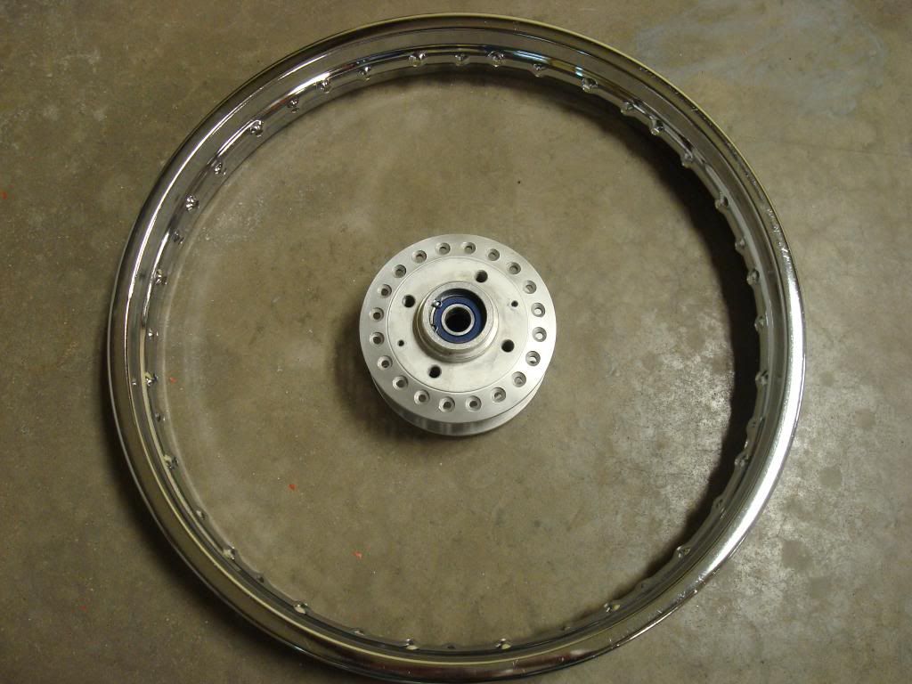

Here is a pic of my finished rear wheel:
The zinc turns dull pretty quickly and doesn't buff out very easily. They still look nice on the bike but are not as easy to maintain as stainless IMO.
